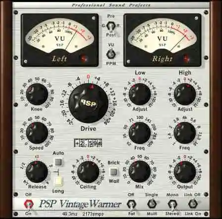

For plug ins, PSP vintage warmer isn't to bad when used sparingly.

have you tried this plug in
Cheers
Alan.
