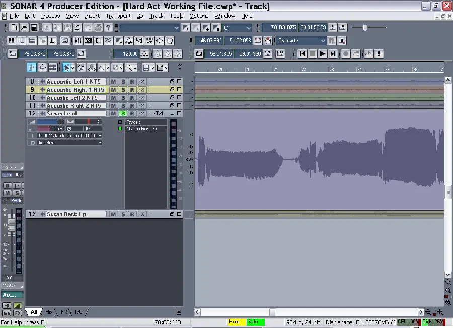

OK, I'm having a problem with vocal dynamics. The singer in my band has a really strong voice. The problem is that when she gets to a part where she goes from kind of quiet to belting, I either have to a) ride the fader on the preamp, or 2) have her back off the mic. The problem is that when I do either of those things, her voice sounds more distant and I'm really liking the upfront sound we are getting on her voice.
Here's my chain:
NTK --> RNP --> RNC --> Delta
I read various things to do about this... such as using 2 mics, 1 condenser and 1 dynamic-- but I read about that in reference to screaming vocals. What I'm talking about isn't "screaming," just getting louder. Obviously I'd like to be able to keep the upfront sound without clipping. What else can I do? Should I get more agressive with the compression? Should I have her back off the mic a little AND back off the preamp a little instead of doing alot of either one? Is there something I can do at mix time?
Here is a sample of what I'm talking about (it's called 'Vocal Sample'):
http://www.nowhereradio.com/artists/album.php?aid=3498&alid=-1
Attached is a pic of the offending part of the vocal track. In the space before the part where she gets loud, I backed off the RNP probably 2 or 3 clicks. If I remember correctly, I asked her not to back off the mic because I was riding the gain on the preamp. But if she backs off the mic and I don't touch the preamp, we get the same issue.
What can I do?

I guess I don't understand the whole situation then. How does she "exericise control?" Not getting so loud? Backing off the mic?
She's got pretty good mic technique and in this particular instance I asked her not to "work the mic." But it doesn't matter, because the results are the same. Whether she backs off the mic or I turn down the gain, the vocals still sound more distant compared to the softer vocal parts.
Are you saying that a vocalist with good "control" can get really loud but still manage to keep the vocals sounding "upfront" without clipping?
Is this one of those recording paradoxes that doesn't really have a good solution?
I'm confused.
It sounds to me that your getting too much "room" when she works the mic. There are 4 possible 5 things you can do to help.
1) Tighten the acoustic properties where your recording vocals. I would even do tests of different "mic to mouth" and "loudness" distances to see when the "room" engages her vocals.
2) She might need to refine her technique slightly to control her volume better. I know a guy that is really loud when he doesn't have to be.
3)Compression - depending on the effect your looking for some compression might help level the overall performance.
4)Track the softer parts seperately from the loud parts and comp them with some compression to glue it.
5) Any mixture of the above.

Thanks for the reply, SoMm.
Yeah, when she backs off the mic, there is definitely more "room" sneaking into the signal. But in this particular instance, I had her stay the same distance from the mic and I just turned down the gain for the loud parts. The effect is still the same-- she sounds more distant and less "upfront." Did you listen to the clip I posted (it's only like 15 seconds)?
I am using compression during tracking. I guess I should get more aggressive with the compression.
I have done the separate tracks thing for loud/soft parts and that seems to help a little... but I still get a more "distant" sound on the louder parts.
Anyway, I guess I got my answer: experiment until you find something that works. It's just frustrating because I love the sound we are getting except for the loud parts.
