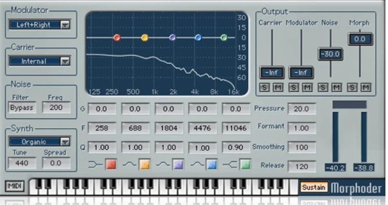

Maybe start with ReaVocode instead of TAL, because it'll make first-time setup a bit easier.  Move on to others once you've got the concepts under control and can fiddle around a bit more effectively.  Morphoder is OK, but not free.  And it can't accept an external carrier, only its built-in carrier signals (or if it can, it's doing it in a non-standard way that I could never figure out).  TAL and ReaVocode can both accept external carrier signals from whatever source you like, and they're free.

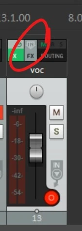

In Reaper, you'll need to put the vocoder FX on a track and change the number of inputs on that track to 4 instead of the default 2.  Click the routing button on the track and from the Track Channels drop-down, select 4.
