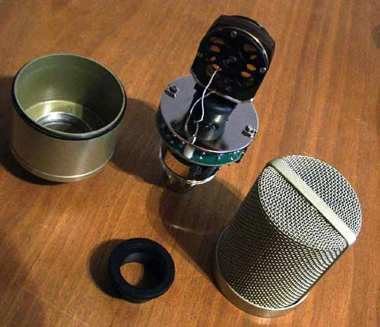

I think you're thinking of a front address mic - the 990 is side address. It's easy to take apart - I think you just unscrew the mesh housing from the bottom (PCB) housing after unscrewing the bottom ring. I don't have access to my mics currently to verify that. Here's a pic of a disassembled 990 housing and PCB (ignore the capsule - it's from an Oktava 219.)
crazydoc,
thats all it was! thanks man i appreciate it....its almost back to the way it was, i can barely even tell where the dent was.
