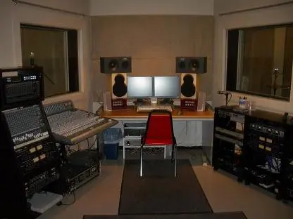

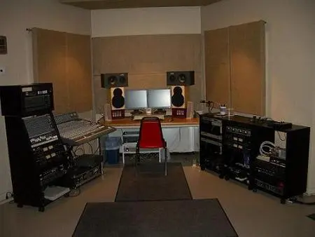

I put one pic of the mix nook in Tracking Mode (panels down) and one in Mixing Mode (panels up).

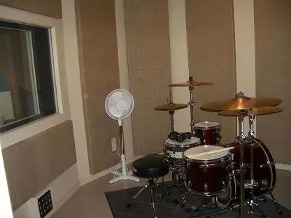

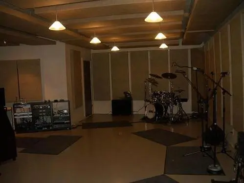

There is a bad pic of the 7x7 vocal booth and one of the 10 x 11 drum booth. The main room is about 15 x 32 .

Very nice. I have a 900 sq ft studio and its nice to have alot of room. I use to mess in a 150 sq ft area. I like all the sound panels. I hope to build a few this winter and put them to use. Looks good.

Kick ass Tom! I always envey the guys with lots of floor space. I dig the window covers for mix time. Great idea.
The window panels work good.
Even though the walls are splayed about 20 degrees each, there is a little smearing of the stereo field because of the reflective hard glass surface. It tightens up real nice with the panels up.
I got to do a rough mix this weekend on a Celtic Band I recorded and the rough quick mix sounds better than the ones I used to pour my life out over.
If anyone wants to hear I'll post in the MP3 clinic.
Tom
That's a great looking space Tom! I too am jealous of the open floor space.
I wish my control room had a window to the tracking room. Our basement isn't as open as your space, so i had to appropriate two separate rooms (tracking is 21x12 and the current control room is 9x13). once i move things out of the other room down there, i'll be moving the control room and it'll be more along the lines of 9x17. big enough to put a couple sofas, which will really make the clients happy.

veyr nice! you're lucky to have such a big room! that's a behringer desk isn't it?? what interface are you recording with?
What cafeteria DID you steal that chair from? ......... Just kiddin'........ Very nice looking space. The lack of clutter is refreshing!
Actually.
It is a Soundtracs Topaz Project 8.
As far as interface, right now I have (1) Lucid 9624AD and (1) Lucid 9624 DA plus (3) Delta 1010s slaved to a Lucid GenX6 Clock.
The Deltas are going away soon to be replaced with 2 RME ADI-8s and a RME 96/52 lightpipe card.
Thanks for asking!
he he!
I actually bought it from Wal Mart.
I need to get a rolling chair now.
The clutter is only days away I am afraid. It gets pretty bad when I am booked. I have to take a weekend every once and a while and shovel my way out.
