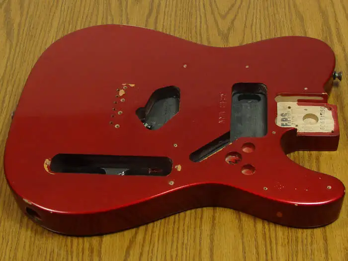

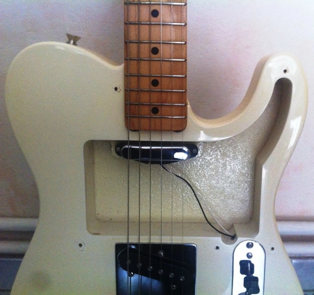

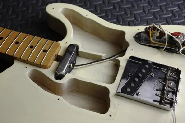

Potentially dumb question: after taking off the pickguard, how will I know if my tele can fit a humbucker or not or will need any routing adjustments? Are there certain measurements or shapes to look for? For example, can I go with any humbucker if, under the pickguard, my tele looks like this:
But if my tele looks like the photos below, then I can only plug-n-play with another single-coil neck pup with similar specs? :
View attachment 92763View attachment 92762
View attachment 92765View attachment 92764

The Tele in the first pic might fit a neck HB with an appropriate pickguard.
The Tele in the second pic, not a chance without doing some gutting.
The Tele body in the third pic is ready for dual humbuckers.
The Tele in the fourth pic looks like it will accept a neck humbucker.
The size of the rote will determine whether you can fit a humbucker. The only pic that wouldn't allow is pic 2 on your list. The pickguard can be adjusted or you can find one to suit with a humbucker sized hole. The bridge route is differant as it is on the slant on a telecaster and will most likely not allow for a humbucker. If it does you will need to get a bridge wiuth a humbucker route. As I say you will not be able to tell untill you get in there and look .

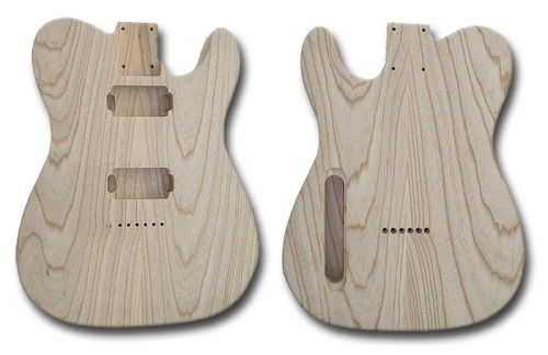

A vintage telecaster route will look like this and will only take tele pickups. If you have more space than this you will probably be OK.
yep, that's what my 72 Std looks like for routing.
