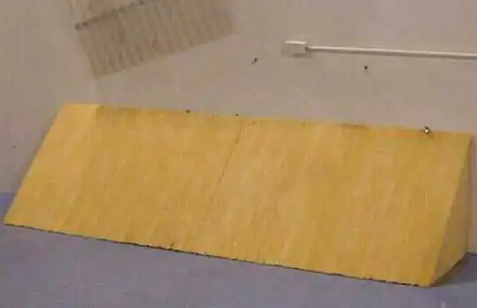

RICK FITZPATRICK New member Jul 13, 2010 #3 Here is one on the floor/wall corner in a testing Lab. All corners are subject to reflection of low frequencies. Hence you can use superchunks in ANY corners. Mine are along Wall/Ceiling intersections. Attachments Chunks.webp 3.8 KB · Views: 121
