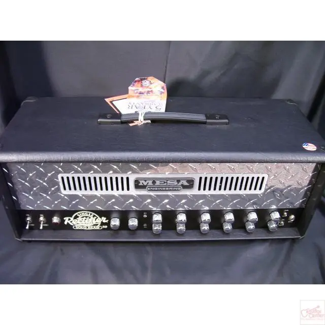

Here's one
Here's one from the auction.
Best I can do right now!

Phecking Sweet man.....you Bastage..... :p
I need to get me an amp...... :( :(
