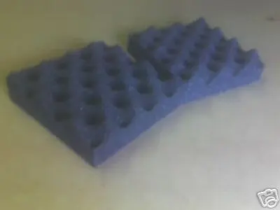

Hey i Found these on ebay i just wonderd if any one could tell me if they would help to prevent sound from travling though a basement celling im not botherd about stoping the sound compleatly just dampening it a bit, will these do the job or are they only good for acoustic treatment
many thanks JIMMY
RECORDING STUDIO TILES
BOUNCE THE SOUND OF YOUR MUSIC AROUND THE ROOM WITH SOUND PROOF TILES
APPROX 240mm x 240mm x 20mm
64 IN A PACK
Starting bid of £25 is for each pack of 64 ( thats less than 40 pence each )

That looks like regular old bedding foam. Who says it's for recording? It looks real open and crappy and doesn't look like it would help a bit. One thing to think about is, is it flamable? If so, stay far... far away from it. Remember that night club with White Snake? Yeah, they used the wrong kind of foam.
The fact that the person putting the auction on says they're "sound proof foam files" leads me to believe they're trying to pull one over on you. There's no such thing as sound proof foam. Unless it's 100 feet thick... :D
Go to www.auralex.com and read up on what good foam is all about. There are cheaper alternatives than Auralex, but they've got some really good descriptions of how foam works and what to look for. And if you haven't yet, read www.acoustics101.com.
I'd agree. When I saw 'sound proof foam' the warning lights went off. Also, for the price, there's no way it can be of much value for anything but high frequency absorbtion. You need a more balanced approach. Either look into Auralex if you want foam or rigid fiberglass/acoustical cotton if you want something more effective and can DIY covering/framing for it.

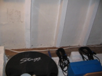

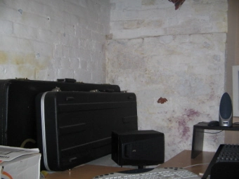

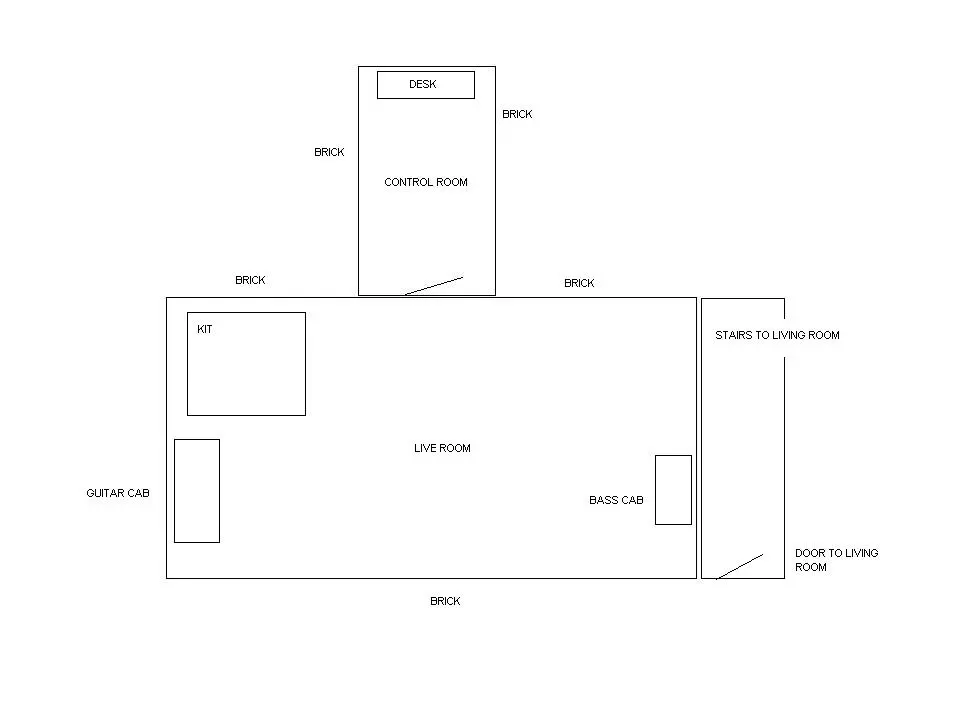

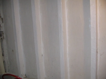

i have added a diagram and some pics hope it helps.
the celling is wooden beams.

Most al of what any foam or insulation will do is effect the how the room sounds inside. A small side benefit is it will absorb a small percentage of vibrations passing through the ceiling, so this will quiet it down some but I'm sure not what your looking for.
You need mass to do this. Drywall/sheetrock to be more specific.
