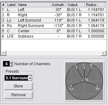

Here's the layout for 5:1 surround Eric.
You can also check out the plan for Guruland
cheers
John
