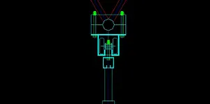

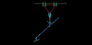

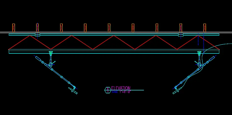

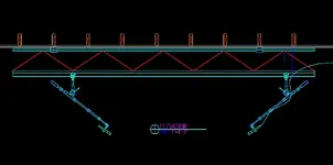

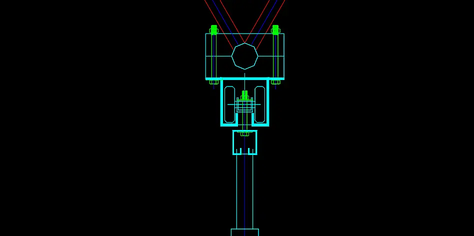

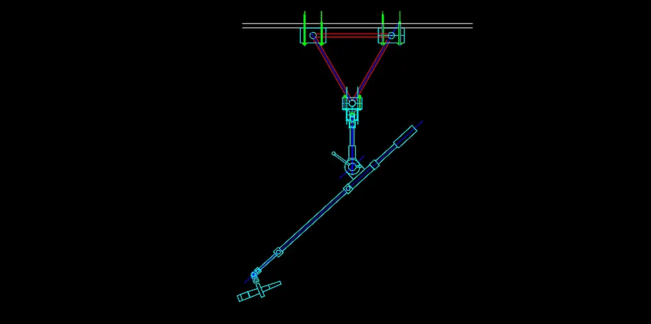

Hello frederic. I've already done it. I made some brackets that fastened (2)10 ft steel tri -truss's to the ceiling, 8' apart. Then I made brackets for holding 2 tracks per truss, (for a pocket door), which hung on the truss. The truss gave room for the rear end of mic booms. Then I custom made brackets that I welded to a short piece of the actual mic stand tube which allowed it to be fastened to the wheel carriage that rides in the tracks., The other end had the standard threads for screwing on the boomstand adjuster. Worked like a charm. I could move 2 mic booms 10 feet per track. 2 parallel truss's 8 feet apart, with booms, gave me a lot of flexibility. I drilled and threaded a hole in the carriages for a lockdown so they wouldn't move. I could rotate the booms, extend them, move them on the track, and angle the booms. One even had a DOUBLE BOOM for awkward situations, and one even had the DOUBLE mic clip brackets for the end of the boom when there were two people or what ever. Anyway, I'll dig out the brackets and take some pics of them. The tri-truss, is what I drew that time for your console, remember? Its out back of the house. I haven't installed it since I moved.
fitZ :)
Well, since I haven't mounted them yet, here is a couple of old files showing the units. I detailed these to know what I was building. :)

Here is the section.
Here is the carriage detail
Wow, Rick, wow.
While I don't have the ceiling height for a truss structure (unless I make it much shallower), I like that idea a lot... VERY cool.
Hmmmm... I sense another fabrication project :)
