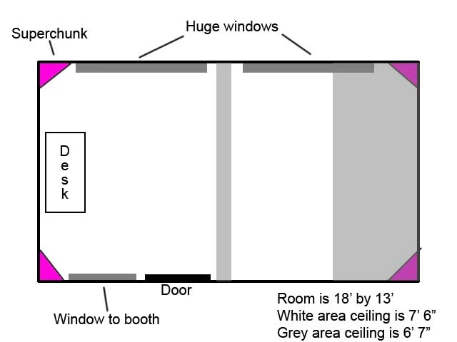

Ok so now that you've seen what I have so far, I'm looking for suggestions on acoustic treatment.
The room is about 19x13, sheetrock on steel stud all around, two big windows on the wall to the right of the mix position, and a small booth window and door to the left. Front and back walls are plain. The 7' 8" ceiling is divded up by a boxed in I beam in the middle of the room, and the back ~4' of the room is about a foot lower (boxed in ductwork).
The booth is about 8x5, but I only use one end of it, the other half is blocked by two standing gobos. The booth is almost completely dead which from what I've read is about the best I can do. For now, the booth treatment is done.
As for the main room, I have installed Roxul superchunk bass traps in all four corners floor to ceiling. The room is not good enough to have band practice in...very hard on the ears, snare and cymbals especially are almost unbearable. I hope to improve this with some more 2x4 3" Roxul panels placed strategically around the room.

Need a floor plan...the pics don't help that much. The only thing I can offer is the basics:
Make sure you setup so that you’re firing down the longest dimension of the room.
Your head should be placed 38% of the way into the room, centered between the left and right walls
Your head should also be located at the tip of an equilateral triangle with your speakers. Start at a 5’ width and go from there.
Use at least 4” bass trapping in all the corners, floor to ceiling if possible.
Use 4” or 6” bass traps on the back wall; the thicker the better basically.
Use 4” panels behind the speakers on the front wall
The reflection points to the right, left and above your head can be treated with either 2” or 4” panels. I prefer 4” panels personally; you can never really overdo bass trapping.
In the case of larger rooms you can use diffusion on the right and left walls near the rear of the room, between your bass traps on the back wall or on the ceiling to the rear of your ceiling panels.
Frank
Here's a rough floorplan...
The panels I can build are all 3 inch as all I can track down locally is Roxul Safe n Sound. They seem to work pretty well though. The corners already have floor to ceiling superchunk absorbers, also made with Roxul SS.
I built 4 2x4 panels and hung them on the back wall, and one at the two side FRP's of the mix postition. A cloud over the mix position is next, and a panel behind each speaker, then the rest of the ceiling to help overhead mics pick up less reflection off the ceiling.

You really should be using 4", but you have to go with what you can get. You could always double up the 3" to get 6", but that would double the insulation costs as well.
I wouldn't carpet the room if I were you. You can always soften a wood (or concrete) floor with area rugs.
