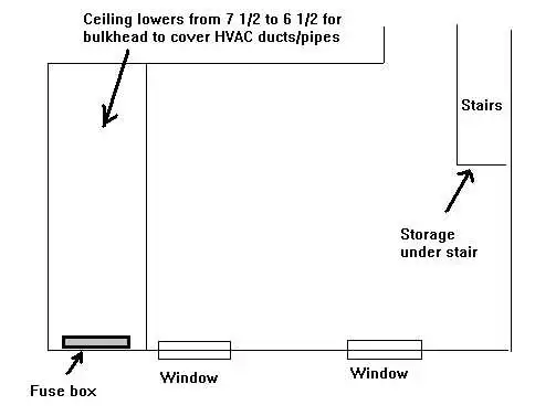

Ok... I'm going to try to attach a sketch.
Here's what I have planned so far.
Ceiling -- Per ethan's suggestion, I will use 12" insulation in the ceiling covered with burlap.
Floor --- some kind of wood or wood laminate
Walls --- I would like to build slot resonators... I am still unsure of the design, how I should tune, Size, placement etc... I have read several posts/articles some w/ plans and I will try to make something similar... any further advice on these would be appreciated.
Corners --- bass traps in the top left and bottom right corners. Because of the fuse box and the stairs I can only place traps in these corners -- will this be sufficient?
Also, when looking at it today, I was thinking it would be easier from the layout if I drywalled ceiling the first 2-3 feet in from the wall and then did the the rest of the ceiling with the burlap/insulation solution -- would this be ok or would it defeat the puropse? I will have to drywall over the lower section of the ceiling to cover the HVAC ductwork (left side on drawing).
Any other comments or suggestions would be appreciated (layout after finished, size/placement of resonators etc.)
Thanks again

What are the dimensions of the room?
Are you going to build a tracking room and a controls room?
What is the purpose, I guess, of your room?
larry
1) the room is approximately 15x18
2) I do not think I will have space to build a separate control room. (is it really necessary? or just desirable)
3) I want to use the room for Recording and as my general music/practice room

Your drawing could benefit from adding some dimensions, wall thicknesses, equipment placement, etc. to better explain what your trying to do. Maybe we can bounce some ideas off of each other, or have a project room build race!

I'll try to make a better drawing later and get the dimentions. As far as gear placement, I am not sure yet what the best way to do it is.... It's all still open for debate.
My burlap reference was a suggestion from Ethan Winer who posts alot about studio construction. He has a company that sells accoustic treatments and he is kind enough to give suggestions to those who ask.
Anyway, originally I was going to drywall the ceiling, but Ethan suggested that it would be accoustically better if I left it open instead and just have insulation. the idea is that I will have a reflective flooring (probably a wood floor) and an open (absorbant) ceiling. I live by myself so I don't have to worry about sound traveling upwards to my living room. To cover the Insulation between the joists, ethan suggested a breathable fabric such as burlp. You can get it in quantity for about $2 a yard in most fabric stores. The open fabric allows the sound to travel through, but adds a better appearance.
So, to sum up, I will have 10 or 12" insulation between the floor joists and a white colored burlap tacked across the joists as a cover. To hide the seams I will be taking a small strip of wood along the length of the joist.
Then, after all is said and done, I will make some Bass traps and treatments for the walls.
