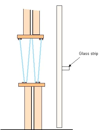

umm i'm kinda trying to avoid the 160 for the 2 panes of 3/8. since it will take so long and is expensive, when i can get 4 panes of 1/4 for $80 and have half inch on each side and cheaper!
mudding joints:
do you just mud the joints just like regular dry wall or is the some other way. also what is the best way to screw 2 layers of drywall to z channel?
Oh Sorry - I see what you mean. Yes you can use 4 panes of 1/4", I'd use just three, but the prob is resonances. One solution is to get a glass cutter and make a thin slice of the glass say 1/2" wide and run it down the middle at 90 degrees and glue it to the outer panes. This will stop it from resonating.
see attached.
cheers
John
