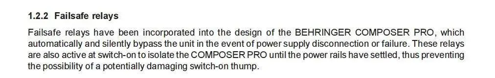

I've got an MDX2200. If I engage the 'IN/OUT' switches on either channel I can hear a click of a relay. That might be something to listen for.
From the MDX2200 manual. Don't know if these relays are the same as I hear and tied to the 'IN/OUT' switches.
"isolate the composer pro until the power rails have settled...."
Great find, if it's relevant to this model! Very good chance it is.

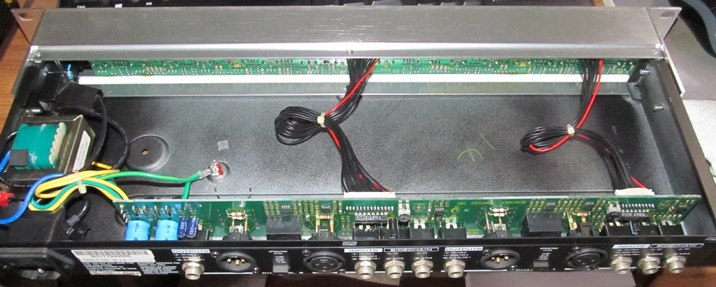

Top diagram on the unit does show relays in the IN/OUT circuit that bypass the compressor section
