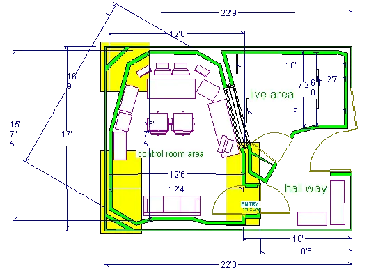

How about something like this ChippyD
cheers
JOhn

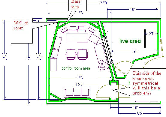

2 new pics and more questions....
I will get this right one day( I hope)..
The first pic shows that the control room is build with no corners in the room.
If building a room this way, will the outer room act as a bass trap or would the 2nd pic be better?
On the second pic the right hand side at the back of the control room is not symmetrical would this be a problem, even though the front of the room is ok?

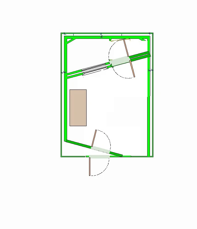

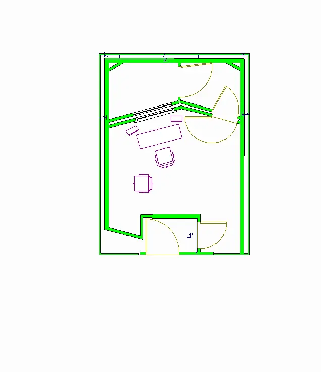

and here is the second pic
Thanks all for your suggestions on the room designs.
I had to redesign it from the first post as I am limited to what I can do with the outer room.
I cannot move the entrance doors so they opens outwards (John Sayers pic) so this is taking up a lot of space.
I have to make the right hand door so it will not open and only the left door will then open inwards into the hallway of my studio.
Any suggestions on pic1.gif and pic 2.gif above would be good as I want to pass this on to a builder to get a quotation.
ChippyD
The out of symmetry is not a problem at the rear of the room - mind you - do you really need two doors?? you are already one door away from the outside, surely one to the control room would be enough :)
