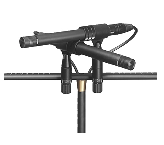

The functionality that you are describing is a function of the mic stand and not the bar. For example, a decent boom stand will allow you to tilt the stereo bar in a vertical position. You can find them anywhere for about $20.

You can also get a straight bar (or one like scrubs showed), unthread one of the sides and thread it in upside-down. Then when you put the clips on they are staggered.

now I have a mod for the Shure that will allow you to run two LDCs in blumlein, thus making it possible for you to do nearly ANY configuration with those two.
you need the shure a27m vert bar.
http://store.aiconsol.com/a27m.html
you will also need a coupler from fastenal...
http://www.fastenal.com/web/product....ex?sku=0148071
Fastenal Co.
Part # 0148071
1/4-28x7/8 COUPL Z
get a female coupling and piece of threaded rod.( the sku on the threaded rod.=0152183)
screw the female coupling to the top of the a27 bar and thread your piece of rod into the other end...bam, problem solved.
Also grab a piece of pvc pipe and paint it black to cover the exposed thread and maintain a professional appearance.
