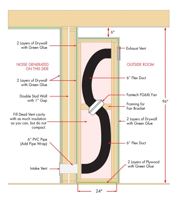

What about heat/ac/ventilation?
Hi,
I'm planning on building ventilation along the ceiling soffit. An extractor fan on the outside wall and a box along the top of the room's corner, with a vent connected by flexible ducting, in an S-Shape, the boxing will be filled with rockwool and covered by acoustic plasterboard.
Heating and ac I was thinking a portable unit that I can blast on and turn off just as recording takes place.
Found an image of the kind of thing I was thinking:
Using this sort of method though, how does new oxygen get added into the room? It seems like it's only a one way sort of method, removing used carbon dioxide?
Would I need two then? One venting co2 and one inputting oxygen?
Hi,
Exactly.

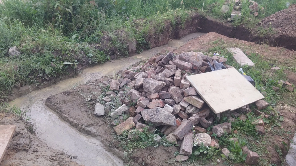

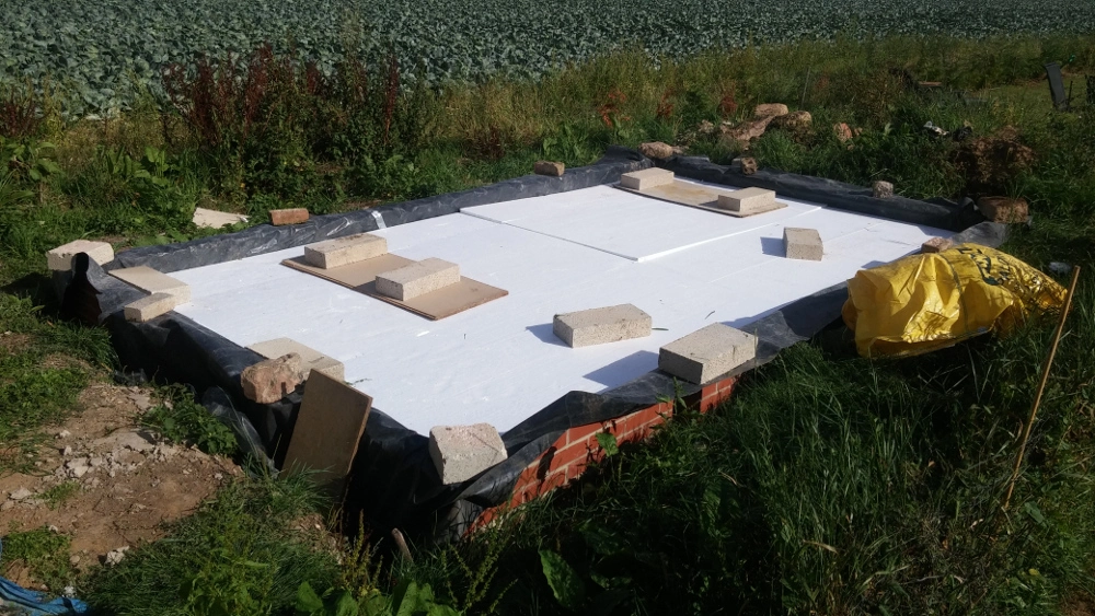

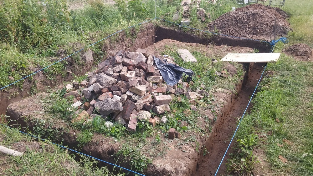

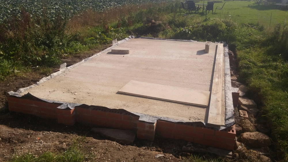

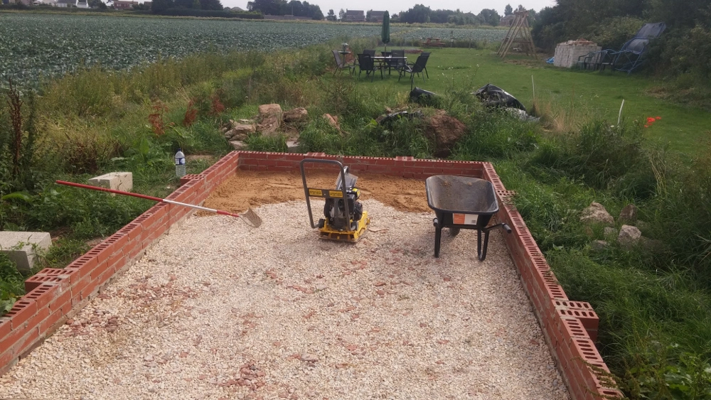

Hi all! Back to my construction of the garden studio!
Concrete slab laid, damp proofed and ready for the room to shoot up.
I'm going to be starting on the internal isolated room's stud work first and get that up without the brick work in the way. Once that's up I'll brick around it. :)
Waka
