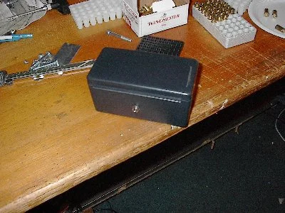

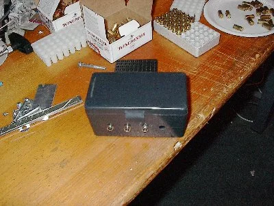

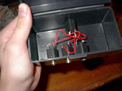

Then use soder and a sodering iron and wire and soder the one input jack to the other 2 this will split your siginal to 2 amps. Here is one that i made i made another one thats better than this one but its at my drummers house.
Boss used to make em but quit. I got the inputs on this spliter off of my old crap stereo so thats why they look like black squares. The box i used had bullets in them you could use and box just drill holes in em for the jacks. make sure you wire it right or you will mess up you amps or somthing, i think you should understand so ill stop typing.
