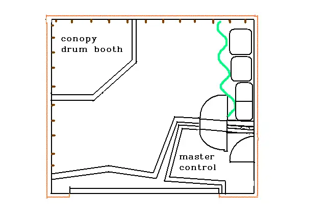

This is not a double wall construction but the garage door opening will be sealed off in front of the steel door. Get rid of the steel door? Hmm. Then another wall will follow behind that. I've got floor plans in some software and will try and convert them.
The control room will be on the oppposite side the drums with a double wall construction.
Most of the dense stuff will be in and around the drum booth which will have a canopy whith a ceiling height of around 6 feet running all the way to the garages ceiling with a facade running around the opening which will be open to the rest of the room. The drum booth will be built in a corner.

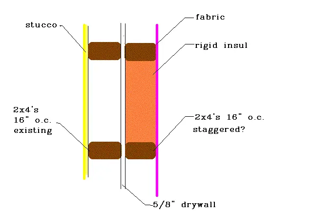

According to the Mike Shea's Building A Home Recording Studio on a Budget. He recommends using only double wall construction between the live room and the control room. Does he not care about my neighbors? What kind of isolation will it have from the dog barking , planes taking off, and the possible child playing nearby.
The construction he has planned in the book is from the outside in like this. First: 1" of stucco Second: 2" by 4" studs. This is what I have existing. Then He goes on. Third: 5/8" Drywall. For some strange reason he did it like this..... He then goes on to say. fourth: 2 by 4s attached to the drywall with fiber insulation fitted between the studs. Finally: Cloth of some sort attached to the studs possibly with 1/2" bead to hold it on.

These are not the detailed plans. But, they'll give you an overall idea of what I am trying to achieve.
The wall plans that O'shea recommended was as follows. He doesn't even use double wall construction.

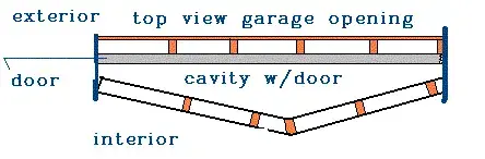

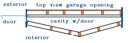

And also, I will leave the garage door there just in case I sell the house.
The tracks which take up the garage door will be removed. Now the door will be enclosed between the new walls. The door will be in the closed position for the duration of ownership.
But, I am wondering what effect the door will have inside the cavity. Is this going to produce a shuttering sound?( a vibration ) And will I hear it behind the wall.
casen,
I understand that your wall plans will be more effective if you eliminate the internal sheetrock layer. It sounds counter-intuitive, but the specs I've seen indicate that staggered stud construction without internal barrier is superior. Then, you may want to employ Resilient Channel to hang your internal layer of sheet rock. If done properly (no small feat) you will get incredible isolation.
BTW, cutting high density fiberglass is easy. Just get an electric knife (the kind dad used to use to cut the turkey) and it's like buttah.
Thanks Tod,
It only makes sense to do it that way to keep any transmission of sound waves from getting in or out. Unfortunately, I will have to remove all the existing drywall I have already put up.
Let this be a lesson. Never believe what the book tells you. At least a book that was poorly written.
