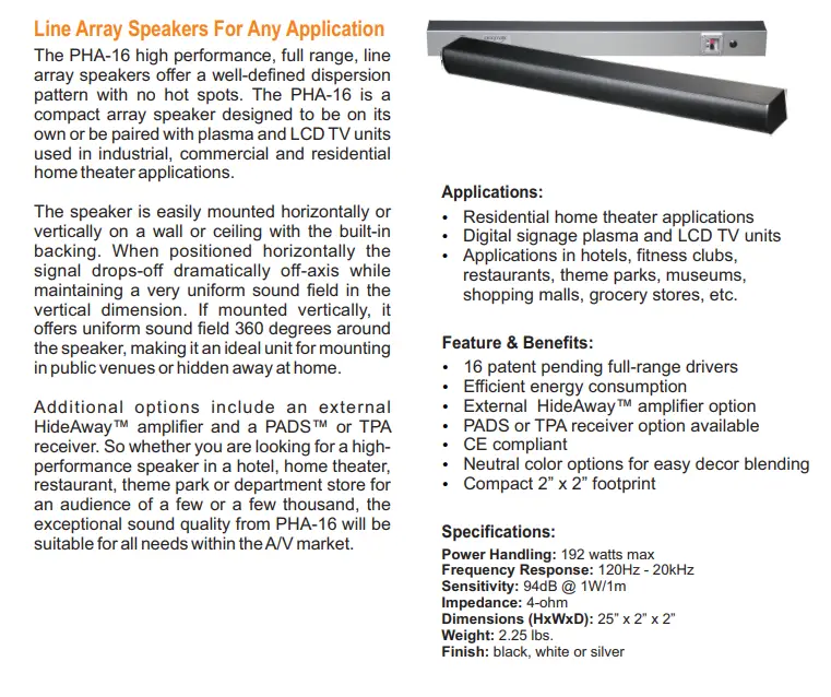

OHM master advice on how to wire (32) 16 ohm speakers inline to end up with a 4 ohm impedance
I have a 250 watt 4 ohm amp and want to drive 2 Pragmatic PHA16 line arrays ( as shown below) with it. There are (16) 16 OHM 1 inch drivers in each stick currently wired in 2 sets of 8 speakers ran parallel then those two sets ran in series to result in the 4 ohm load.. Naively thought I could just send the 4 OHM amp signal to both 4 ohm speakers not realizing that creates a 2 OHM load on the amp
Would sincerely appreciate advice on how to go about wiring these so I can end up with 32 of these tied together with a sum total of a 4 OHM load..
