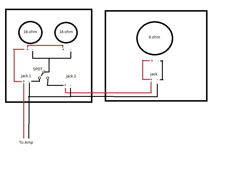

So I'm building speaker cabinets for my guitar amp. My ideal set up is two 10" speakers and one 15" speaker. The idea was to make them into two cabinets (one 2x10 and one 1x15) that I can stack onto each other, or for a smaller gig I could just bring one or the other. What I have are two 16 ohm 10" speakers, which I basically got for free, and that cab is almost done. Still need to get my 15" speaker, but I've got the box built for it, and I still need to get the jacks and wire for both cabs.
The idea is that I would wire my two 10" in parallel, making that an 8 ohm cab, and then get an 8 ohm speaker for the other cab. Btw, my amp has settings for 8 or 16 ohm. From there I wanted to wire it so that either cab on it's own is 8 ohm and have them connect to one another in series so when stacked the impedance is 16 ohm.
I've tried finding some info how how to do this, but haven't had any luck.
Is this possible?
