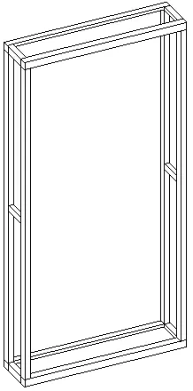

Drilling holes will take ages and you will wish you didn't half way through, so it thought of a new way. Get 1"x1" wood and build like the attached pic. Thats wot I'm gonna do.

I guess when i go to the store tomorrow im just gonna buy wooden dowels but recangular ones...seems liek that is what pandamonk is going for. also..a i need opinions and help on this...

What kind of wood should be used?
Anything really, i'm guessing. Just go for something cheap. I'll leave this for someone else 'cause it almost 2am and i need my sleep :) night
