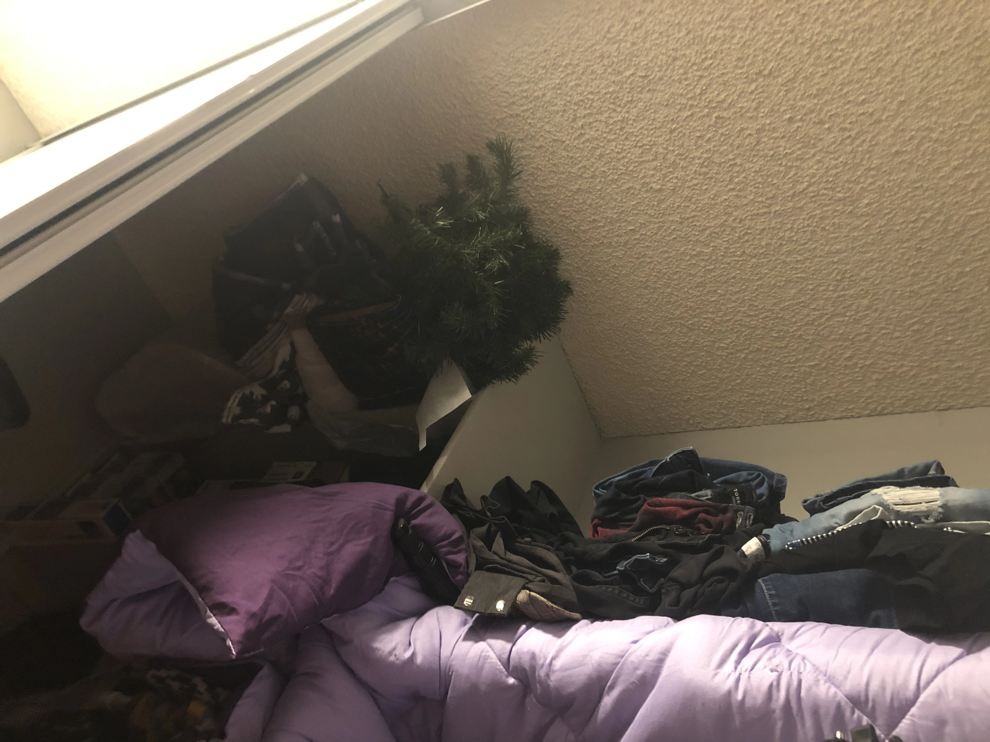

So I’ve posted a bunch about setting up my recording space and based on feedback from here I switched my recording space from a small closed closet to a larger open closet for voice over work (I have a 600 sqft apt so options are limited) and it overall sounds better.
however, I did not know before setting up the new space that there is a loud plumbing pipe going across the ceiling of the space and keeps ruining my recordings.
Is it possible to soundproof my popcorn ceiling in my apartment? Pictured is the ceiling and some shelving so it’s kind of an odd shape.
Thanks!
No, you cannot soundproof it. The sound will transfer through the walls too, not just the ceiling. Only MASS soundproofs - and you need to be surrounded by it.
If you plan on being there for some time, I’d suggest installing a suspended ceiling under the existing ceiling. It would look like the ceilings that you might see in an office, with the 2’x2’ or 2’x4’ ceiling tiles. In between the suspended ceiling and the existing ceiling, install 2’x4’ batts of mineral wool insulation. If you’re mechanically inclined you could possible install it yourself and save some money. There’s always a solution, it just depends on how much time and money you’ve got to devote to it. Good luck!

That won't 'soundproof' it, although it will cut down some of the noise. Unlikely to be allowed in a rental apartment!
Soundproofing is very tricky to accomplish in an already-built room. I know I’ve had to do some things in the past that the landlord might not have agreed with, but there was no permanent damage to his property and, well, he wasn’t aware of it either! Maybe another option is to get to know where that plumbing pipe feeds to/drains from and get friendly with the neighbors and record the affected tracks while they’re not home? There’s usually a solution somewhere, and it’s usually expensive or time consuming, or both. Best of luck in your soundproofing and in your recordings!

If you (a plumber really) can get at both ends of the pipe you could fit "flexipipes". These would stop a good deal of the sound transmission through a rigid pipe.
Also explore its length and ensure it does not touch any part of the ceiling woodwork. If it is securely clamped to a joist say, UNclamp it and secure by flexible means. The rubber fittings used on car exhausts could work?
Water pipes shouldn't really be noisy, likely air in the system that needs bleeding.
