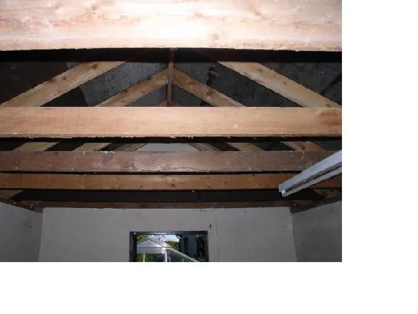

OK, so assuming I go for staggered steel studs and a few layers of plasterboard for the walls, how do you think I should approach the ceiling? Here's a few pic's
Hello teamdresch, What makes you think you need staggered steel studs? What woud you do with the studs opposite the sheithing studs? Especially if the walls are concrete.
