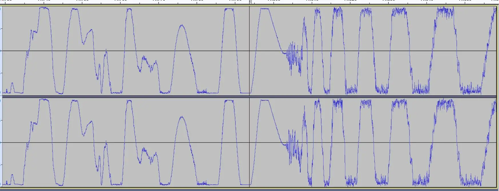

I used a Soundcloud downloader to look at the song. Its MASSIVELY distorted. This is section at around 40 seconds in. It's consistently flat topped like this for the majority of the song. It's no wonder that sounds like dog poop!
Since I can actually hear it on my laptop, that clip-distortion comes across as just another 'sound' to be incorporated into this genre's palette. Like that zipper noise I used to get when I overloaded my Stereo VCR on mixdowns.
I looked at a number of posts of Snavs songs from the list on the Riotville Records page and the majority of them are maxed out, although not all were clipped as badly as that post. Still, it's the epitome of the "loudness war" sound. If the track doesn't look like flat land, it's just not loud enough!!!
It doesn't have to be that way. I have heavy metal albums that are clear, don't pump and aren't clipped. They just sound good.
I'm unfamiliar enough with this genre to make the bold assumption that it's the creator's intent to have it end up sounding the way it does.

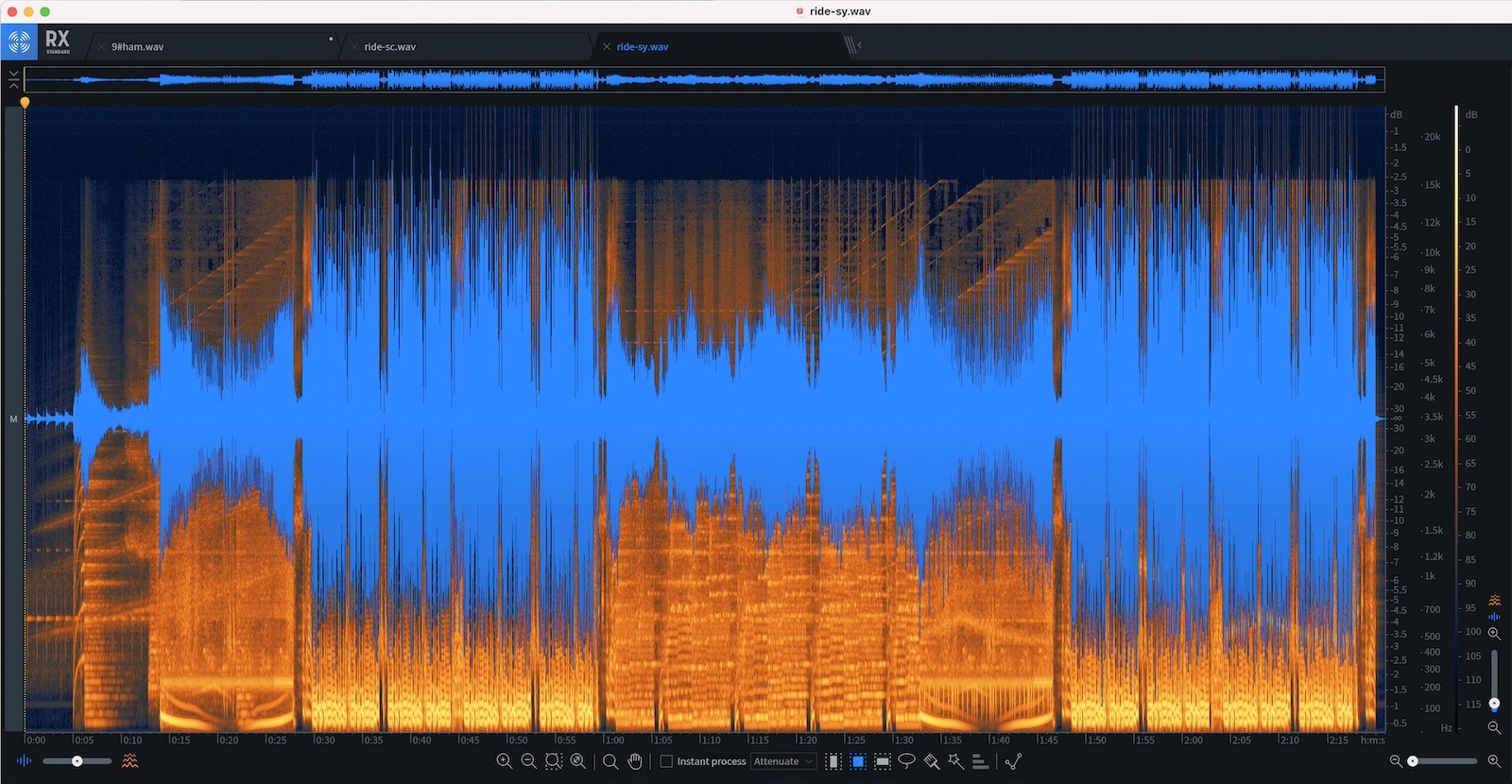

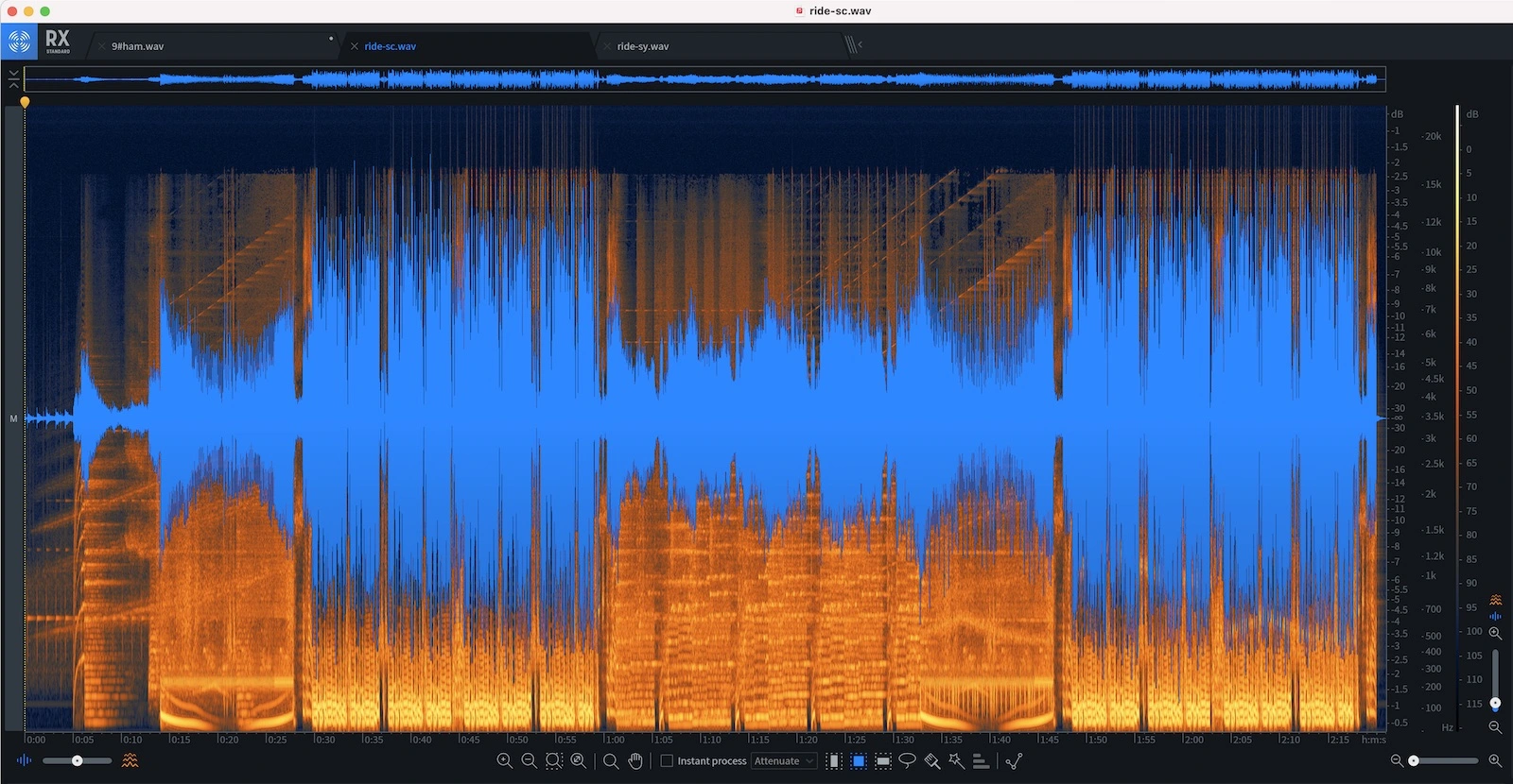

I just recorded off my headphone jack, which I left unchanged, and recorded it as MONO on my Zoom F8n. I recorded them low enough that my limiters (on all channels and I don't want to mess with settings and forget..) did not kick in. Then I normalized the Spotify version up to -1dB peak, almost 5dB gain. I applied the same gain to the SC and it ended up at -1.08dBFS peak. Viewing in Ozone, it's obvious the SC version has taken more of a beating in the trip to lossy streaming (IMO).
And they do not sound the same. The Spotify version, at a -1.0dBFS peak normalization, measured exactly -17.0 dB LUFS, while SC's measured -17.3 dB LUFS. (Actually a measurable amount "quieter!") In addition, the Spotify clip is lopped off pretty quickly around 15.5kHz while the Sound Cloud one extends out to 16.5kHz! (If I have not gotten them mixed up.) I did not look at subsonic content, which is where I can imagine things can get weird, and possibly one source of what's making the Rokit's jump about.
The captured files images are attached. ride-sy = spotify and ride-sc = sound cloud.
Pure speculation because we don't know what was uploaded to each service, but we can probably assume that with Spotify's billions, they have better compression algorithms at work, so that may be a part of it.

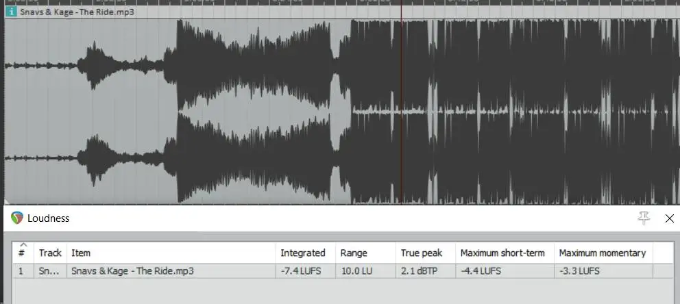

Keith, did you look at the peaks to see if they were clipped? Since you did a capture from the headphone output, your level could well be lowering the max levels, but if they were clipped it should still show up.
I downloaded the mp3, and when I measured it, I got a LUFS of -7.4, not -17.3. Looking at the spectrum with BlueCat's analyzer, it has a sharp cutoff at 16K, but had high levels all the way to 10 Hz. Also, the loudness true peak of +2.1 was pretty much duplicated with the RMS metering in Reaper, which showed a +2.5dB max peak. I know that comes from the MP3 reconstruction.
When I listen to the Soundcloud output and compare to the mp3, they sound exactly the same.
Just one last item, the mp3 download is at 128kbps which totally explains the 16kHz cutoff.

I didn't capture the digital signals, but the analog output from my Steinberg UR44C of both sources. I think whatever clipping can be seen, it's "baked into" the original mix/master. Yes, I turned the levels down, because I didn't want what I recorded to show clipping that was a result of my own fumbling. As I said in my first post, we know Spotify levels output. I don't think SoundCloud does - reportedly it doesn't - and my [A/D] recording suggests that the output level there is about the same as the Spotify version, which OP says doesn't cause distortion. That actually surprised me, because I thought I'd see a much louder SC track.
I had the level set on my headphone output and gain on the Zoom F8n so it would not clip. I recorded both the output from SoundCloud and Spotify with the same settings, and level-wise, they were about -12dB LUFS. It depends how I scale the output how it looks, and I did a mono recording, so some cancellation may have occurred, removing some flatness. The point was, the digital streams would have gone to the DAC in my Steinberg, and if they had been the same, the audio would have been the same, or certainly not as different as what I saw. What we don't know is whether Spotify and SoundCloud got the same original file, i.e., did Spotify get a non-lossy, 24-bit upload, and SoundCloud an MP3 of that, or what?
