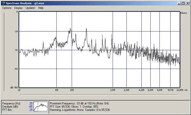

This is why I'm always going on about the limitations of human hearing and perception. Attached are two screen-caps showing an FFT (spectrum) analysis of both files as created in Sound Forge using its highest resolution. As you can see, the spectral content is for all intents identical. There are tiny differences, but they're all down at -80 and below. So that doesn't account for hearing a difference.
I bet $100 that if I blind tested you here ten times in a row, half the time you'd pick g1.wav as brighter, and half the time you'd pick g2.wav. That's just the way our hearing works when differences are subtle or non-existent. I've seen and performed tests playing the same Wave file for someone a few times in a row, without them knowing it's the same file, and they report hearing small changes. This is also why some people claim to hear a change - always for the better, of course! - after replacing one competent AC power cord with another.

Of course what I call high end presence might be something else. Like recorded detail. To much of it can confuse conventional equipment attempting to play it back in all it's glory. I should probably isolate a few bandwidths and compare to be sure. The clips as a whole are hard to distinquish, but isolated bandwidths should be more revealing.
I guess as far as scientific goes.
the amplify effect in audacity says 2.3dB for g1, and 2.1dB for g2. So g2 is louder by 0.2dB (in theory).
bandpass in sox. (14.3.0)
sox -v 0.9 input.wav output.wav bandpass -c 6k 10
afterwards amplify in audacity is 5.4 for g2 and 6.2 for g1. Less the .2dB from before and g2 is still .6dB louder in that bandwidth. Or would it be 1.0dB louder? Which verifies what I previously thought. More there in that annoying baby screaming frequency range from the Apogee(sp?).

I have no idea what that's saying. But I do agree with this comment by you, which confirms my main point that converters don't vary nearly as much as the vendors would like us to believe:
