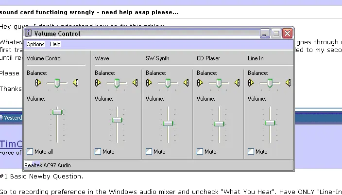

Sorry I cannot see that button, or checkbox anywhere... I am using XP professional... I have included a screenshot of the screen...

As I said, unfortunatly some sound cards dont have this setting... It may not be your problem then... Or you may find it amongst the "Recording Properties" of the mixer app...
Indeed we could be chasing ghosts anyhows... Some cards dont have the "what you hear" feature, it could be something diffrent entirely...

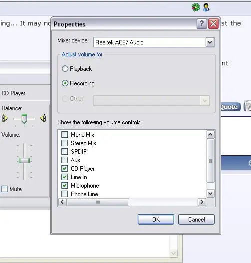

Don't appear to have it, here are all the options I'm given... what else could the problem be?

ok, when you click recording on that options, then hit OK the mixer should change to the recording mixer... (Volumes) Have you made sure that the only one checked is the "Line In"? And you say its all your music software that is doing this? :)
yay!!! problem solved! I only selected 'line-in' and now it all works fine! Thanks!
