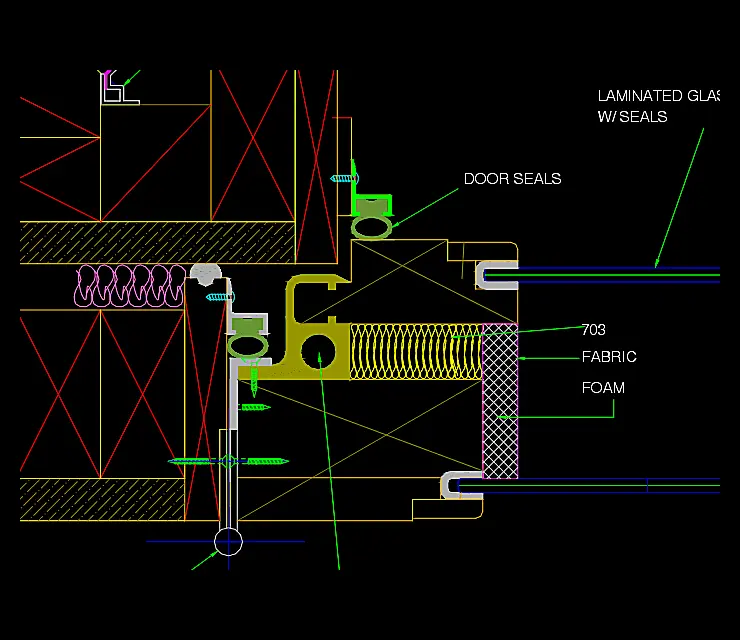

fitZ :)

Well, lets not jump the gun here. :D There are tons of questions that need to be answered prior to doing this. First off, let me admit that I have not personally built a booth from this design. Second, there are some details that haven't been technically worked out yet. Like the "decoupling seal" between the two leaves of the door. This is based on a design from an Aircraft DOOR SEAL. It would have to be "custom" made seal by an Aircraft seal manufacturer in Oregon. Probably BIG BUCKS!! :eek: As a matter of fact, this design, although using common and readily available materials, will still take a hell of a budget. Especially with the size you are talking about. Which I don't see a need for 10 foot length, unless for duos or something. Remember, this is actually a "room within a room" design, which means it will be EXTREMELY heavy. The panels are all 3/4 MDF, which weighs in at about 100 lbs per panel, and for the size you're you'er after, you're looking at about a minmum of about 25 panels :eek: :eek:
I don't have time to go into detail here, but there are some questions that need answers before I begin posting this stuff. For one,the sections and details are NOT finished, as I started this project over a year ago. It takes time to draw this stuff correctly, and some of the details haven't addressed the physical properties of hardware and availability of such things as venting fans, ducts, fabrictrax, hinges, glass, seals, fiberglass isolators etc etc. This design REQUIRES absolute precision when cutting panels, which means having them cut by a cabinet shop. It also requires KILN DRIED lumber, which is WAY more expensive than standard grade lumber, which is wet and shrinks after building the modules. YOU CAN"T DO THAT or you will have real assembly problems. Which is another animal. Assembling these modules will be a lesson in the reality of SQUARENESS. Anyway, I have to go. I'll post some questions tonight. One thing this will require, is an existing space with a CONCRETE floor. You can't build this on a second floor or a wood framed floor. Too heavy. These are the kinds of things that we have to answer.

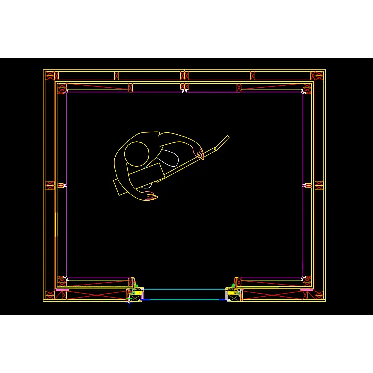

This means having the means to to precision cut and assemble HEAVY MDF panels/framwork and the room to do so. If you do, let me know. In the meantime, here is a look at a simplified plan section. This is NOT finished and is for illustration only. You could stretch the dimensions to fit. However, I believe this sort of structure STILL requires approval from the Building Inspection Department to erect, as it is HABITABLE space, and confines a space within a habitable space. I could be wrong though. However, there is one thing here that you need to understand. Any time you build something that is within the confines of a habitable space, if built without permits when they are required, your insurance is in jeprody. Second, you DO own this space don't you? Building anything in a rental is potentially a waste of time, if not illegal.
Anyway, here is a basic plan, but is by NO MEANS finished. There are many more drawings to this and many things are NOT shown in this. It is to illustrate THREE concepts. This first concept is a TWO LEAF (MASS AIR MASS)assembly, where one leaf is supported by a frame, and the second leaf is decoupled from the first. The second concept is the second leaf is an INSIDE OUT assembly :eek: In other words, the framing for the second leaf faces the interior of the room. Beteen the leafs is an airgap as large as you want to make it or have room for. In this case, it is 4". What is NOT shown here is the insulation. Hence a "structural" plan section. On the interior, between the framing members is 3" Owens Corning 703(rigid fiberglass) which is NOT shown. This airgap between the leaves recieve typical BATT type fiberglass insullation. I will show this in the next drawing. But not untill you tell us what we need to know in order to suggest a solution which is appropriate.
The third concept is modules. This whole booth is designed to be built in modules. The exterior WALL leaf is 8 modules. The interior leaf is 8 modules. The floor and ceiling are another 8 modules. This is actually based on a typical crate design. However, it is much more complex, once you see everything. Lighting, absorbers, fabrictrax, cable interfaces Ventilation(HVAC?) and the biggie, the door, which may or may not be glass. Glass and the special seal as shown could concievably cost $1500 alone. :eek:You might wanna price ONE sheet of 3/4" MDF in your area too. And the price of KILN DRIED and MACHINED 8quarter Poplar. This does NOT come as 2x4's. It must be cut and surfaced by a shop Hence the suggestion of PLY or MDF framing. Anyway, here is the basic plan section.
fitZ

As far as isolation is concerned, DRYWALL is the best bang for the buck material for MASS. However, there are two caveats. Drywall is for PERMENANT situations, as you must deal with the edges. And with permanent construction, you have to deal with the permit issue. For TEMPORARY or KNOCK DOWN, you still need MASS, which MDF will give you, but you need facilities, sills/ tools to precision cut/machine it.
Guys, there is NO getting around the use of MASS for isolation. Yet mass alone will not get you there. What you need to realize is a MASS AIR MASS- TWO LEAF ASSEMBLY with one leaf DECOUPLED, and a HERMETICALLY SEALED AIRGAP is the road to isolation nirvana. How far you take the MASS and AIRGAP elements determines your TRANSMISSION LOSS. It is familiar territory for those who are used to building isolated structures. However, one little slip in the DECOUPLING will destroy all your hard work Here is the deal.
I was told by an acoustician in Europe, that an isolation experiment was conducted at the University that he attended. They built a CONCRETE "room within a room" structure, with each of two leaves formed from ONE FOOT THICK concrete :eek: The interior shell was decoupled and floated within the exterior shell, and they provided a sealable access to the interior through both envelopes. In the first experiment, witness's were placed around this concrete "box", and a 9 mm pistol blank was fired within the interior shell. No one heard anything. In the second experiment, a small wooden stick was wedged in the airgap whereby it touched BOTH shells.
A small radio was then played on the interior at normal listening level. It could CLEARLY be heard on the exterior by the witnesses.
This is what you MUST realize. Structural transmission of sound vibration is your achilles heal. Decouple the interior leaf, and you will substantially increase the transmission loss. Doubling the Mass will give you at best, 6db improvement. This means if you have one layer of drywall/MDF on each leaf,
two layers will ONLY improve this loss by a theoretical maximum of 6db. If the one layer scenario gives you "X"db TL at 125hz, doubling the mass will only give you "X + 6db", at best. And LOW FREQUENCY can be a real problem. Suffice to say, this subject is very difficult to explain in one post. What the bottom line is this. In order to SUCCESSFULLY isolate a given source, you MUST know the db profile of the source, in order to effectively design an assembly with a TL to isolate it. I know of one homestudio builder who has a TOTAL of TWELVE LAYERS OF DRYWALL :eek: :eek: :D That is the reality of HIGH SPL isolation. Especially at low frequencies. And this doesn't even consider the problems of "floating" the structure, OR the structural elements that must be in place to support this weight, especially at the ceiling. :eek: Imagine suspending 5 layers of drywall from an existing roof framing. Ha! Well, thats the reality of HIGH SPL isolation. Don't believe me? Read these and you will begin to understand....maybe :rolleyes: Thats why HIGH SPL/LOW FREQUENCY isolation cannot be achieved with a "knockdown" solution. Unless you have a forklift to move modules with 4-5 layers of 3/4" MDF. ;)
