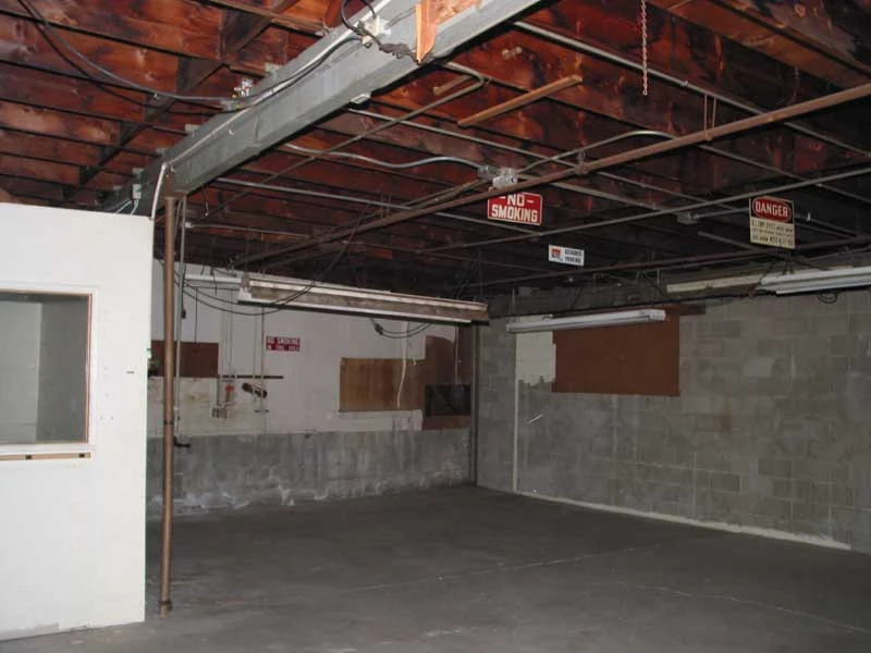

Before
This is the area where we will go about our business.
To describe the room...
East wall is 37 ft long by 9' 7" (Concrete block)
West wall is 31 ft long by 10' 10 (1/2" drywall & r13 insul)
North and south walls are 29' (N wall partially below grade, S wall 1/2" drywall and insul)
South wall is square to east and west walls.
South wall aslo has 7' garage door.
The photo is looking into the north east corner. This is also the direction of the residential area.

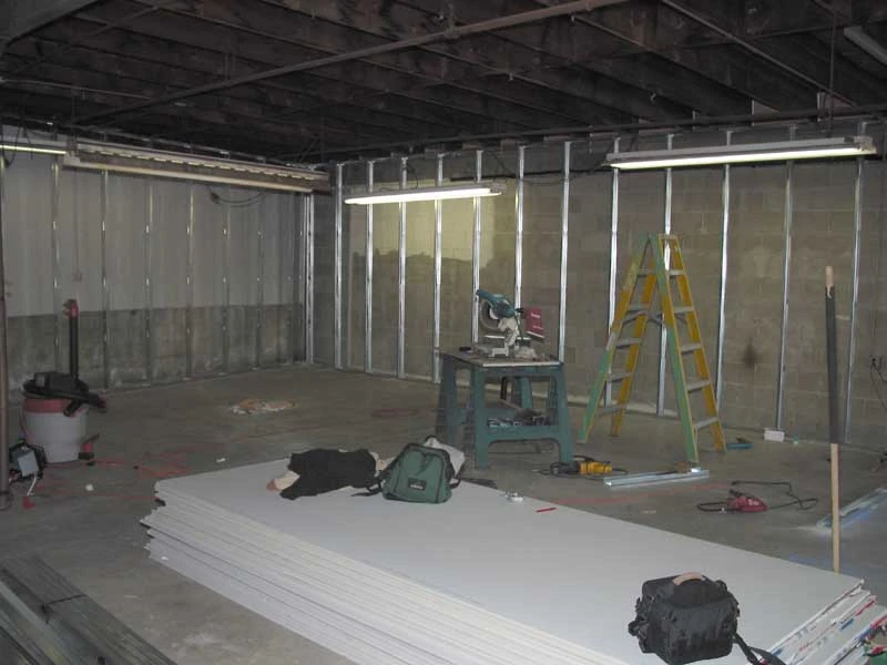

Currently...
Currently we have metal studs to the rafters and have blocked in the voids between the ceiling joists and the header beam supporting them. Outside the frame of the photo is a 9x12 patition separating the garge door from the rest of the space with a 36" insulated metal door to allow passage in and out of the main area.
I have made a few decisions regarding how I will proceed. The sound proofing guy who gave the $3400 bid for insulation and duct liner was basically a finished product option. Meaning that if it was not sufficient in reducing the volume to the outside world I was kind of stuck. The duct liner is applied with mastic and it would make removing it to add other means of reduction nearly impossible. The plan was to cover everthing.
I have decided to go for better mechanical isolation because I fear this is my greatest enemy. I will preface this with the fact that I cannot afford the entire room within a room structure. I have future plans for the space that require it to be large and open.
Here is my plan:
1.) I purchased enough RC-1 to cover the entire room, walls and ceiling.
2.) Tonight I will get the r19 insulation to cover the wall that I constructed and to cover the entire ceiling.
3.) I will apply rc-1 to the metal studs and to ceiling.
3.1 I am strongly considering hanging drywall on the ceiling over the area where we will set up (20x28) to reduce the volume coming though the roof at it's most intense point.
4.) Hang drywall to mounted rc-1 on the walls that I built.
Seal with liberal amount of flexable caulk.
5.) Say a prayer
6.) Put down a temporary rug and apply Drummer with kick drum.
My sound test is to call him with my mobile phone and have him strike the drum a few times in no particular pattern to see if I can hear it from the parking lot of the building I am concerned about. Pending it's success or failure I will move around the block and observe the volume from those positions too. I might even inculde the bass player in the noise if it goes well enough on the first go around.
I know this is primative but it is the least labor intensive way I can think of to find out what I have accomplished.
If I deem the test a failure my plan will be to cover the entire ceiling with drywall, test and then mount rc-1 and hang drywall in the rest of the room if needed. Eventually I will arrive at an acceptable solution. I do not expect the impossible but I do want to avoid any complaints. The combined cost of my incremental plan is much less than the quoted $3390.
Whew, it was quite a day of considerations.
Am I on a highway to hell or does this plan seem like a possible way to accomplish my goal.
Cheers, RD

The framing is complete and things are moving along nicely Today we installed about 1/4 of the insulation. the rest of the week will be preparing for drywall. Everone is taking next weekend off and then full steam ahead to finish the drywall.
I think it is going to work out fine. I am excited that this time last week it was an empty room and it's already starting to take shape.
Cheers, RD
