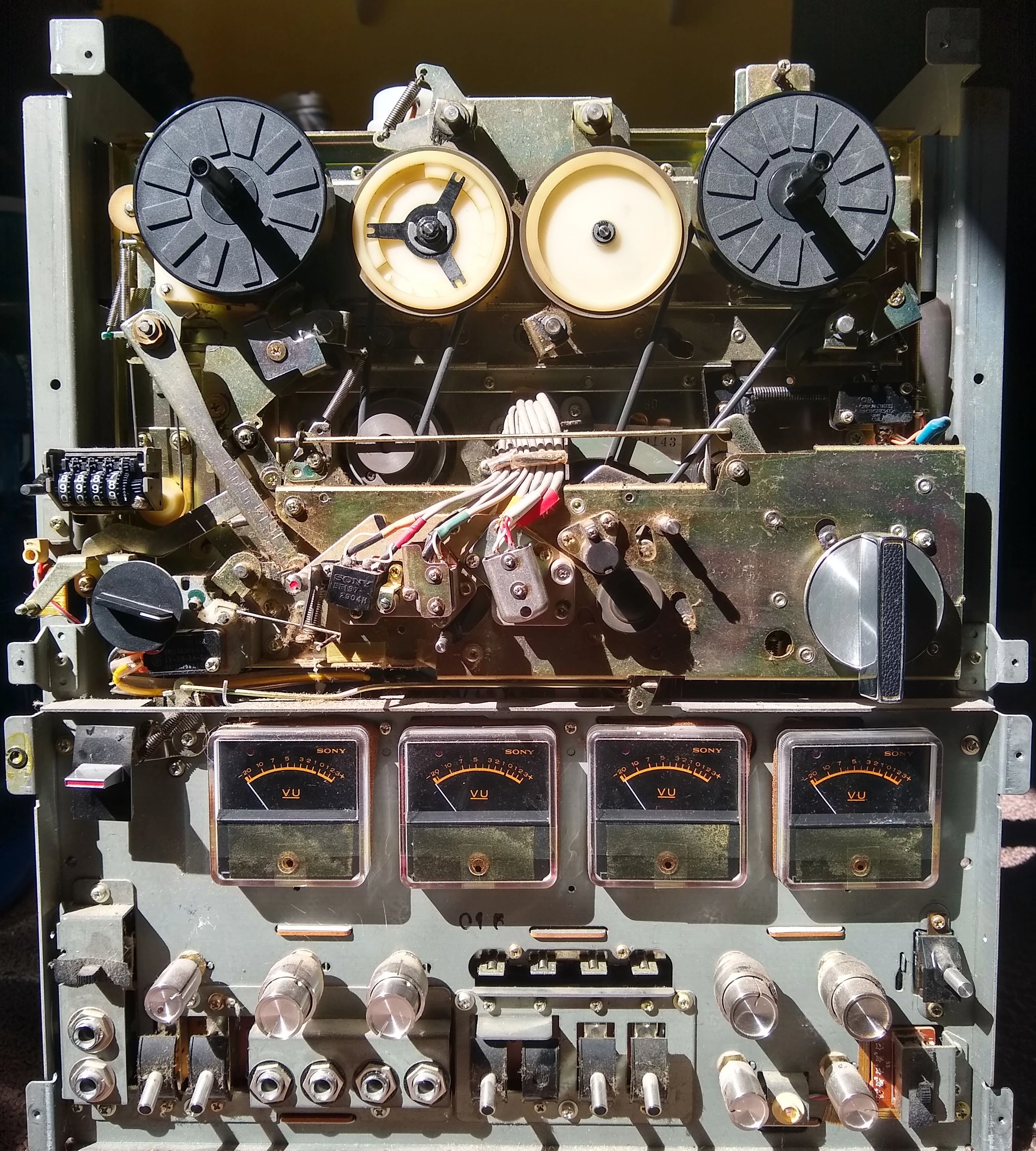

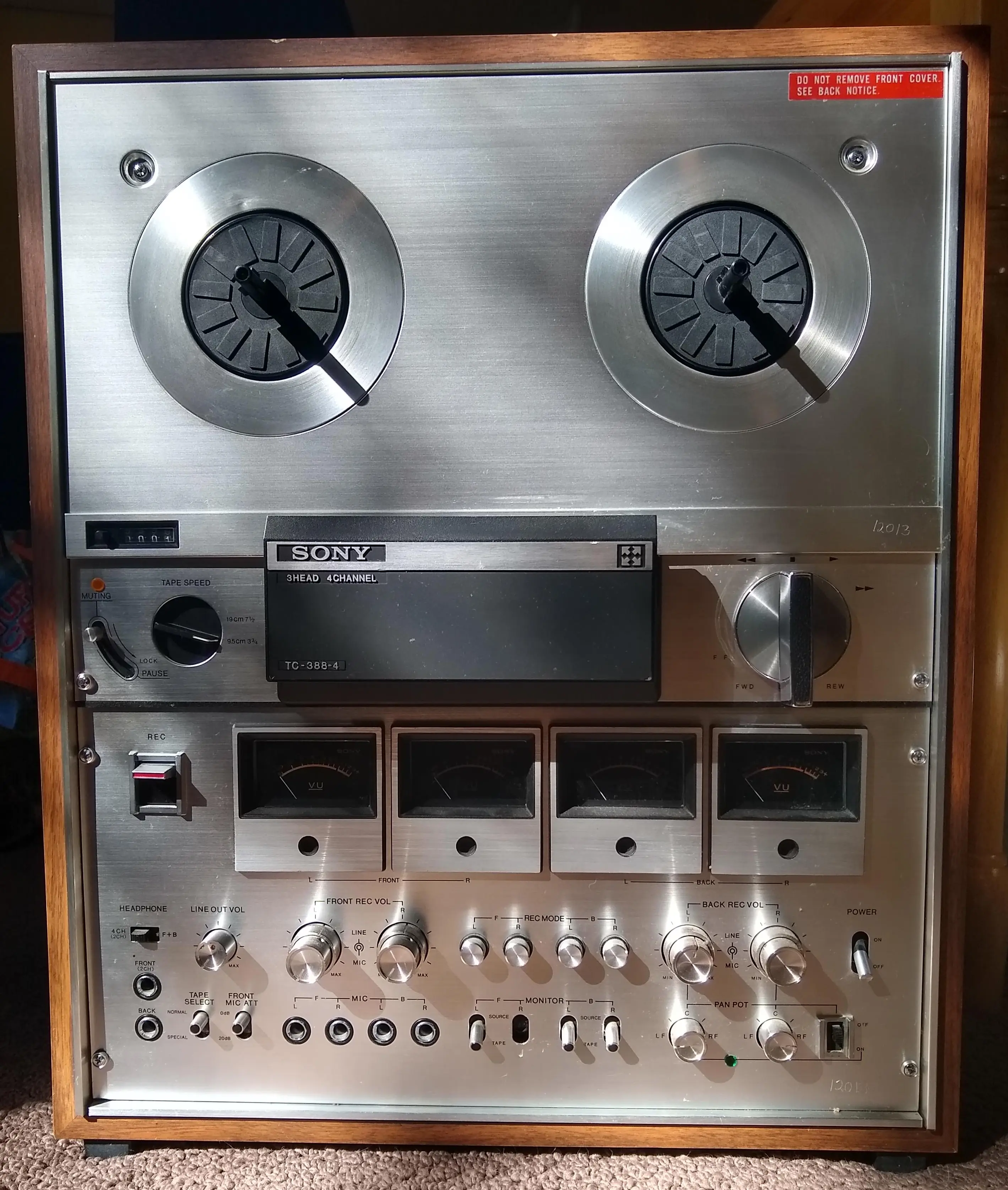

I'm all about recording in digital and staying ITB, but it's not for lack of experience with analog systems. So, to back up my analog cred and to give everyone something interesting to look at, here's my Sony TC-388-4 quadraphonic open reel deck. It sat in my closet for years waiting to be made functional. A few nights ago I started tinkering with it, and before I knew it I had the front panels off and the chassis out of the case. After working on it the next day for another couple hours I had it actually running fairly well, though it really needs belts and felts. One thing I really need is a more attractive spare reel.

And.. Looks like that deck was built on the TC-377 chassis? Serviced a couple of those, good reliable 'hi fi' machines if a bit 'clunky'.
I had a TC-277-4. You could record two tracks (Front) and then do a simul-sync of sorts and overdub two tracks on (Rear). Looks like this could be used as a four track with the individual record buttons!

You can't use it as a four track recorder because it's a three head deck and you can't monitor off the record head Simul Sync style. So anything you overdub will be offset by the distance between the heads and the speed of the tape.
But I suspect it will play back four track tapes. My use for it is more for digitizing tapes rather than recording anything new, so that works out okay. It's also fairly effective, though not absolutely ideal, for digitizing half track and full track recordings. On one full track mono recording I have, I used the two middle tracks and it came out pretty good.
I picked up a belt kit and put it in. There's still an issue playing at 7-1/2 ips and it might need a run capacitor, but the belt kit fixed the counter.
