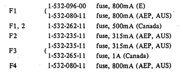

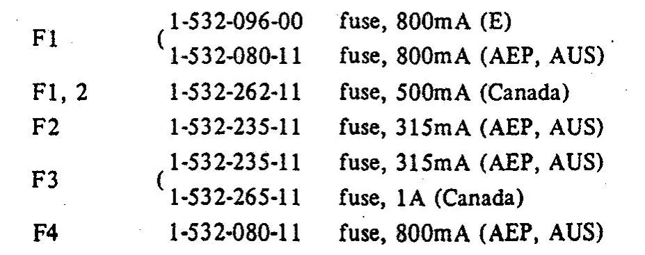

Here are all the fuses in the TC-377 and their values.
Voltage doesn't matter...amperage does.

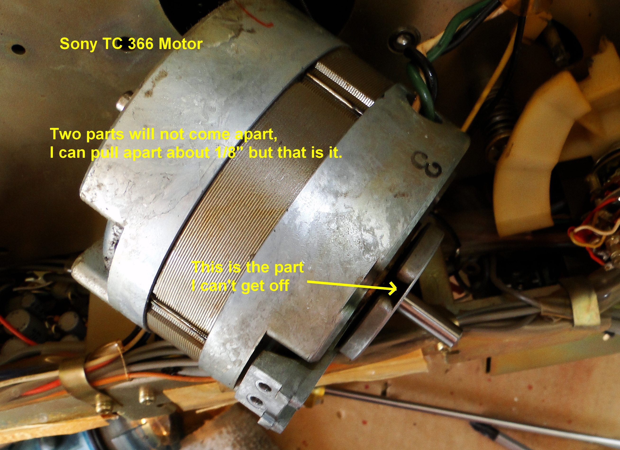

My problem was the run/start capacitor which I have replaced. The problem was the old one oozed wax on the main motor, so it will not start. I have been trying to the motor apart. I have everything off except one part which looks like it has an allen key holding in on. Nothing I have fits. Still I figured the motor would come apart but no luck. How do I get the two pieces of the motor apart so I can clean all the wax out? Trouble Part.webp
I replaced it and motor seems to be run fien after I help it get going but once it warms up the wax on teh bearings harders and it will not restart. I am trying to get it apart but can't get the two halves of the motor apart. Not sure what the comment about word processing is.

Tape was engaged so motor was running all night. Capacitor problem fixed, now need to get the motor apart to clean out the wax in the bearing but can't get the two halves of the motor apart. I have removed everything I can see that holds the two parts together but they still will not come apart. If I can get them apart I am sure I can clean everything and it will work. Thanks.
