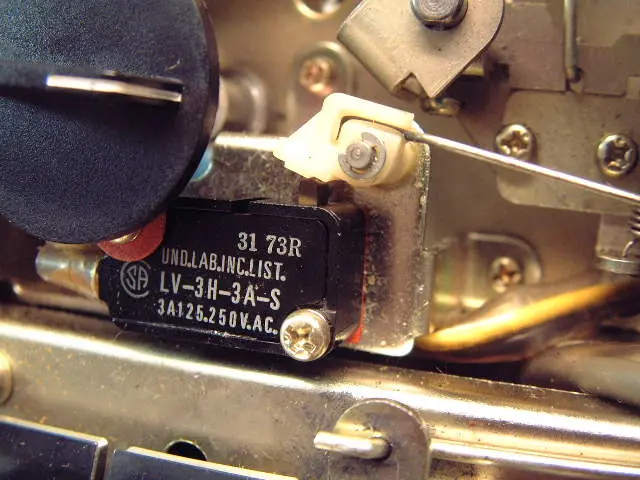

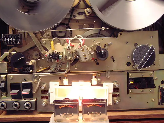

Did you test with a tape loaded ? :)
There is a small rod on the left side of the headstack that engage the motor, without tape..no juice.
Look at the pictures below:
