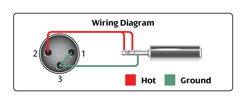

This cable "might" work>>> Amazon.com: Hosa XVM-115F Microphone Cable, XLR3F to Right-Angle 3.5 mm TRS - 15 ft.: Electronics
I have this cable I use with the stereo mic input on a camcorder. The cable is wired to take the mono output of a mic and put it to both the left and right channels of a TRS jack on the camcorder. Your recorder has a similar TRS stereo mic jack. It might work or it might not and the cable is cheap money to find out.
