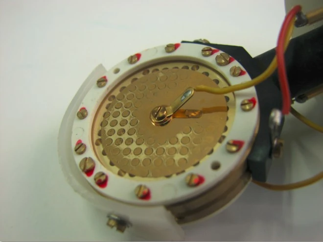

... A poor cleaning job and probably removed the gold layer.
Well, as far as I know, few (if it’s not none) recording engineers will take out the capsule and do the cleaning themselves. They take great care of their mics, may I say sometimes better than they take care of their own eyes. They seldomly lend their microphones (like a U87) to other people, some won’t even let others lay a finger on them. The capsule in the picture was taken out for the first time from an U87ai after been used for 4 years. The owner didn’t even know how to open a microphone. So I don’t think unprofessional cleaning is the answer to what happened to the capsule. And the stuff on top of the diaphragm is not just airborne dirt and moisture, I think.

I don't see anything on the top of the diaphragm. All I see is missing gold.
I also don't see anything on the diaphragm, except a lack of gold because its been scrubbed off.

Most likely any build-up or contamination on a diaphragm is not some form of "metal oxide". If it were gold oxide it would be dark brownish red, and any other metal oxide collected would appear as a salt.
The things that build up on diaphragms are either spit or electrostatic particles like synthetic fibers, possibly some small metal shavings, but that would be rare. I've seen other things like glue vapors or spray compounds, but again...extremely rare.
A normal AF condenser mic. has a very high impedance capsule (GigaOhms) and a fixed charge. This tends to attract dust and the like to the capsule by electrostatic action.
It also attracts cigarette smoke and particles from a smoker (hence the worse contamination on old mics where people were allowed to smoke in the studio). Tar deposits can build up if you are not careful - and if you smoke "other substances" ..........................
