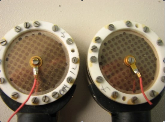

In the picture below is one capsule, nice and clean. This type of capsule is called center-terminated capsule, you can see that the electric contact point is in the center of the diaphragm.

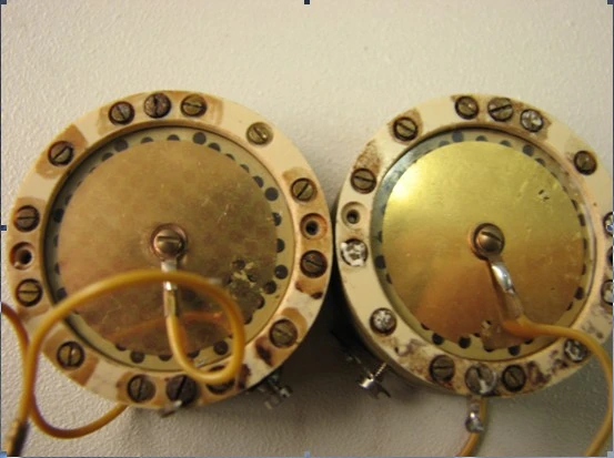

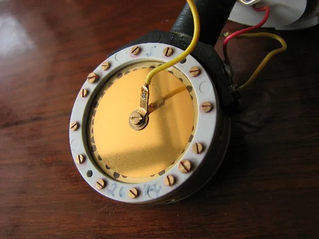

Now have a look at the following pictures,these are some old (used) capsules taken apart from used microphones. You can see that there are stains on the surface of the diaphragms. The accumulation of the stains such as dusts, moisture condensation of the hot breath or sometimes hot and wet air etc will cause the drop of the insulation resistance between the capsule’s two plates.
The top ones look like 797 capsules and the bottom are KK87. I've seen capsules in much worse condition, which were working just fine. Sorry, if I am still missing the point...

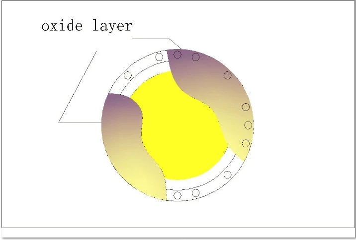

Also, there would be a growing oxide layer as the microphone ages.

When the oxide layer grows all over the surface of the diaphragm and reaches the back plate, it acts like a resistor with great resistance paralleled with the highly insulated capacitor.
If my memory is not that rusty, the oxide is a chemical composition of oxygen and some kind of material. The part of the picture you show contains Mylar, as well as plastic (the clamping ring), which both to my knowledge are immune to oxidation (i.e. fusion with oxygen).
Furthermore, Gold (the Mylar coating) is not a very easy metal to get oxidized, either. In the pictures you posted above I am still trying to understand what is wrong with those capsules, as apart from slight signs of Gold peeling (most likely amateurish attempt to clean), they all look they should work just fine.
