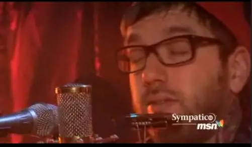

so today i was watching some online performances and i came across this http://music.sympatico.msn.ca/City+...Articles/CityAndColour.htm?isfa=1#msnPlayer_p
his name is dallas green and he is well known in canada but i am not so sure about the states. anyways i really liked the sound he was getting and noticed that the vocals were being sung into a LDC and what appears to be a dynamic mic setup side by side behind one wind screen. is this a normal setup and what is the idea behind it. sorry if this seems like a stupid remark but i just never thought of recording like this and was just wondering what benefits there might be to it.

My quess is the vocals go to the Manley but the harmonica goes to the
Shure (condencer voc. mic )
Matti

They are using both mics together on the vocals. You can tell because of the careful matching of the capsules positions. The Manley, if you've ever used one, is such an extremely sensitive and accurate mic....it works well on an intimate singing style like this song was presented, but its really really clean. The Beta is probably being used for 'color' on the vocal. The M50 (or maybe an M149), down at the guitar soundhole level is much the same. In order to get the boom out and yet retain the clarity, they put up a mic way up the neck. I couldnt tell what it was, but the stringy attack on the slides between the chords are being generated here and I'd bet the bass is rolled off the Neumann.

You may be right, I was just thinking this situation ;)
Matti

Maybe, but again, hes not going to 'cup' the harp and 'work' the mic with it and as your close up shows, these capsules are very close together. Were they to be using the dynamic for harp only it would seem that it would need to be away from the other mic.... It leads me to think they're using them as one. I have done this on several occasions and the results are fantastic.
