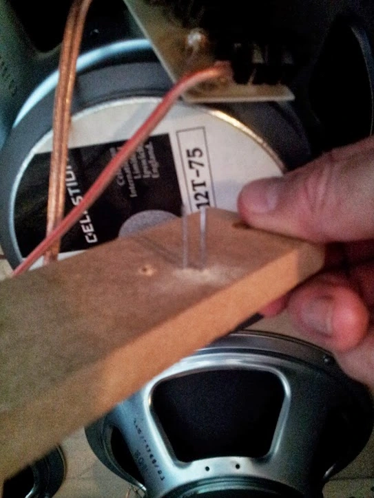

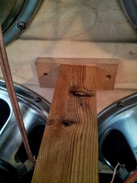

I have a fairly standard JCM900 1960B 4x12 cabinet. It was making some flubby buzzy noises at high volume, and I didn't like the bass response that much, so opened it to see what was going on. (it's got the stock Celestion 75 watt 12" speakers - I plan to change those to greenbacks at some point). I noticed that the wires connecting the speaker terminals to each other and the input of the cab were really thin. I also noticed a 2x2 wood plank running horizontally from the front panel in the center of the 4 speakers back to the back panel, where there's a screw that connects with it from the outside. Once the back panel is off, it's very loose and kind of hanging off the front panel. I removed the dinky wires and soldered in some fat copper 12 or 14 gauge speaker wire, but noticed that there were tiny little wires running from the speaker terminals to the internals of each speaker anyway.

The flubby buzzing I had heard appears to be the loose brace I mentioned. I don't want to remove the grill cloth if I can avoid it to tighten it to the front, so would it be a good idea to:
- glue and or diagonally screw it from the inside to the front panel,
- additionally brace it with a vertical piece of wood running from the center of the horizontal brace down to the bottom panel of the cabinet, or
- simply remove the horizontal brace altogether?
