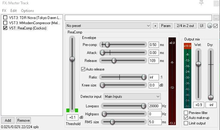

Ally, you have a limiter in Reaper that can limit your peaks. You can also use ReaComp, with a rather aggressive compression but only for the very large peaks. Set the threshold above the normal program material and only react to the high peaks. I have a setting that does about 6:1 compression, limits output and adds Make Up. I'll set the threshold above the majority of the track level, and it kicks in to cut peaks and bring up the level. It has worked well on some vocals that had a few spikes, but doesn't really change the majority of the track, although the Make Up setting will bring up the level of the lower portions.
Many thanks for that, Rich. I've tried various limiters and compressors, but not ReaComp, so I will try that.
UPDATE: Yes! It did exactly what I needed (clip just my wild peaks), using some careful tweaking (although I don't fully understand all this plugin's features). Strangely, the next day, after re-recording some of the project's clips, I couldn't get it to tame my few wild peaks. I had to do some micro-editing of the project, instead.
