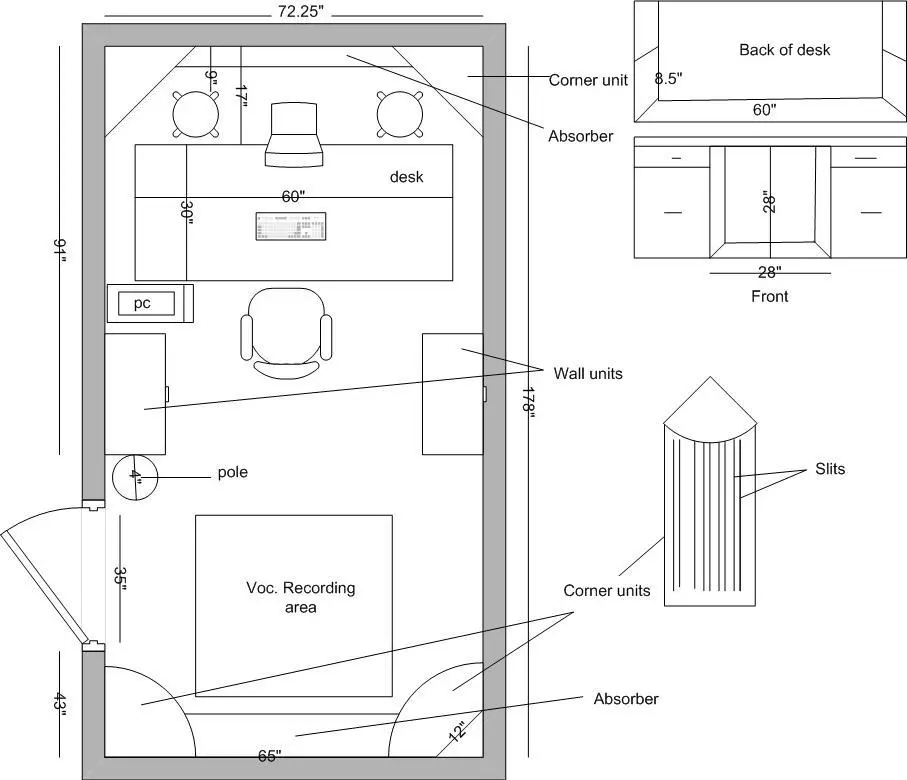

With my room dimensions being limited, would it be a good idea to soofit mount my nearfields? I have a pair of event 20/20 bas.
I have posted a drawing of my room. My thoughts are to build the monitors into their own free standing "case" and then screw it into the corners of the room.
Good , Bad, Other suggestions?
PS I would follow Johns plans from sae, with no angle.

looks easier
Is that 703 ( equivalant ) behind the black area?
Thanks
Ryan
No that's the soffit mount for the speakers. It's at 90 degrees instead of the standard 60 degrees, which would suit your layout. :)
cheers
john

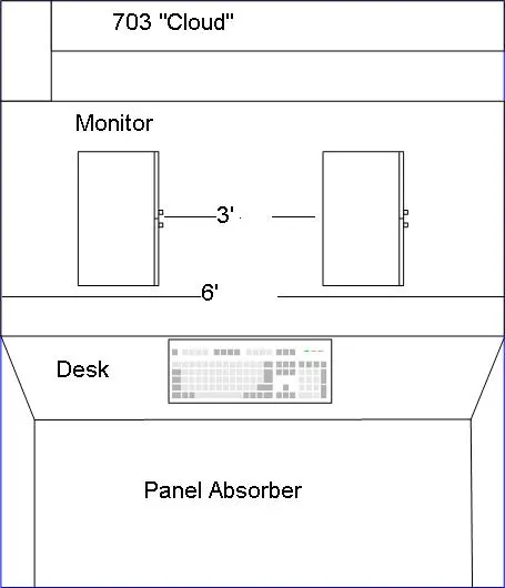

Is this correct?
I now imagine something like this?
