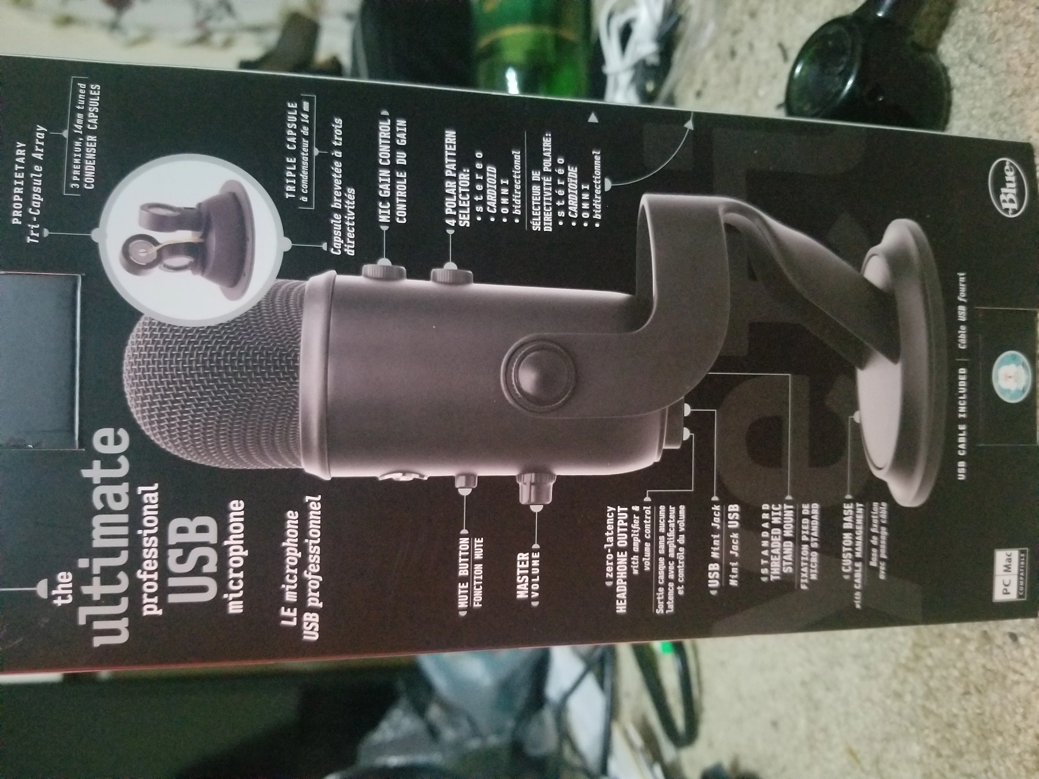

I appreciate your input, replies & information on this topic.
I went with the Blue brand mic on the advice of another, and figured the interface would be of use, as well as that it'd be something diverse in digital environments. I don't really have any MIDI equipment, so I'm working with what I have. Granted, this new laptop I have is a freakin *BEAST*
With my mic, I've got a pop filter, a boom arm & a stand for it, if I need it. Should that be enough?.
Do you at least have the Yeti Pro with the XLR output? That would let you add an interface for more versatile use of the mic.
There doesn't appear to be an XLR connector on that mic. It's a closed system, unable to be used with a separate audio interface. It's probably okay for what you're doing, but it's limited.

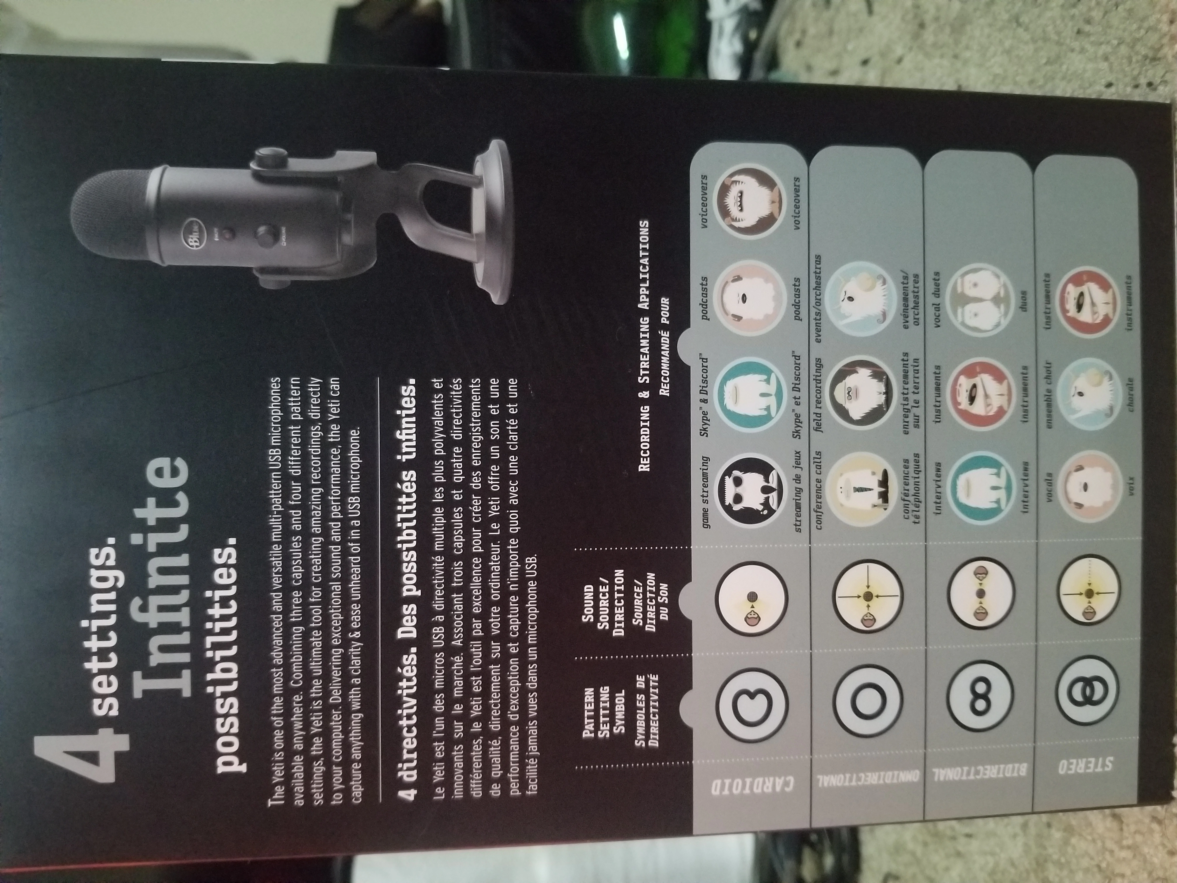

The mic has replay capabilities via the headphones socket, so it's a kind of one-stop shop, but your computer sees it as a single device under windows, so if you want to connect loudspeakers, then your laptop would need to be able to use the input from the mic, but use a different usb device or the internal audio output to connect to other things - and few people have much luck with that. It's designed for simplicity - as in plug in and record, but then complicates it with the multiple patterns, which are things more advanced recordists use ..... sometimes. Most folk don't use fig-8 or omni patterns very much - so its a bit of an unusual microphone.
