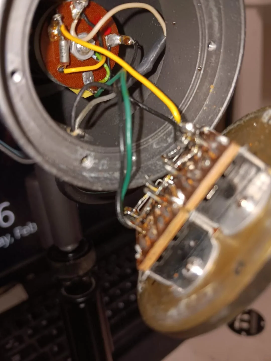

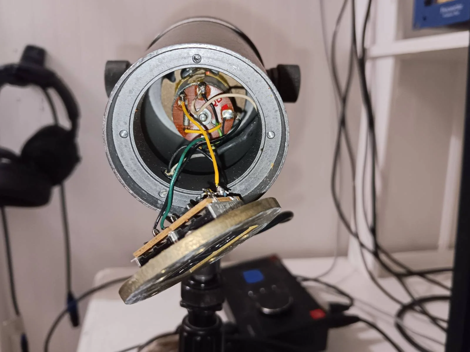

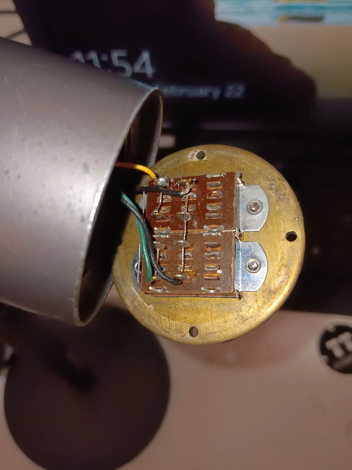

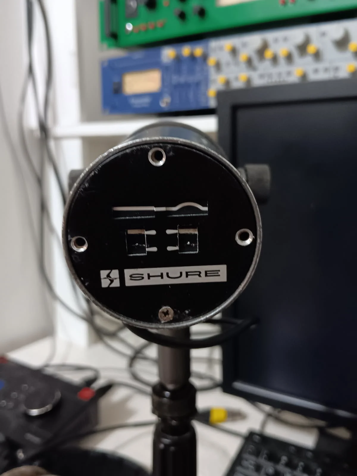

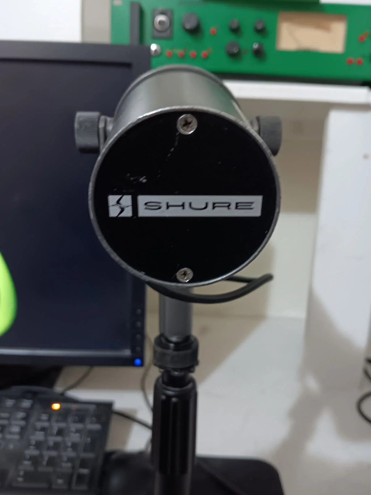

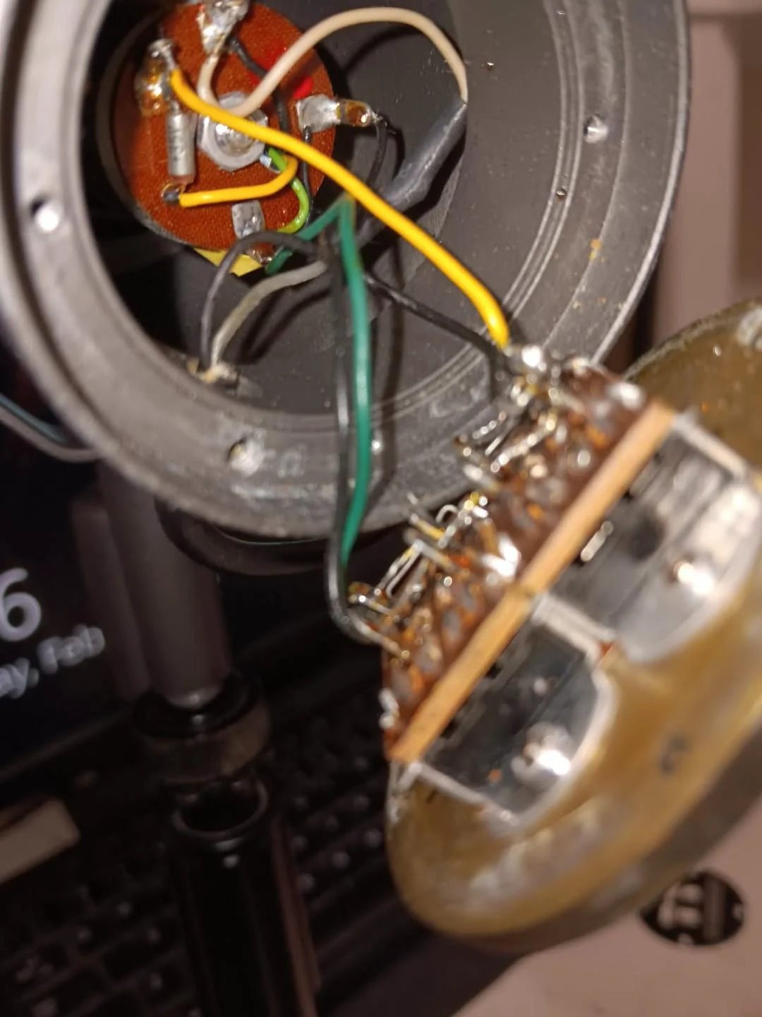

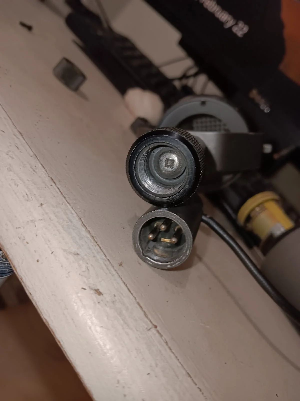

SM7a/b humbucker coil
more pictures of disassembly -

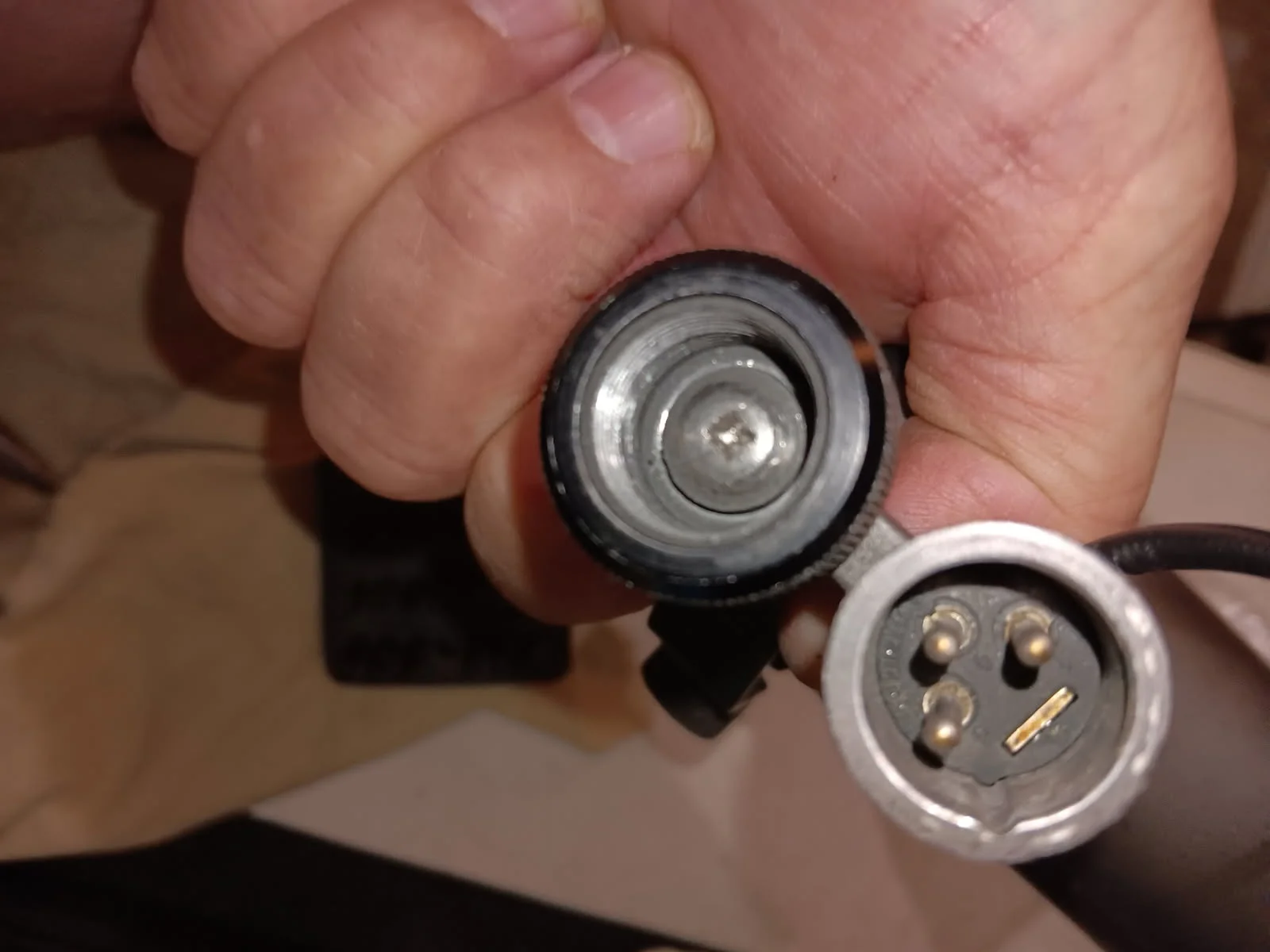

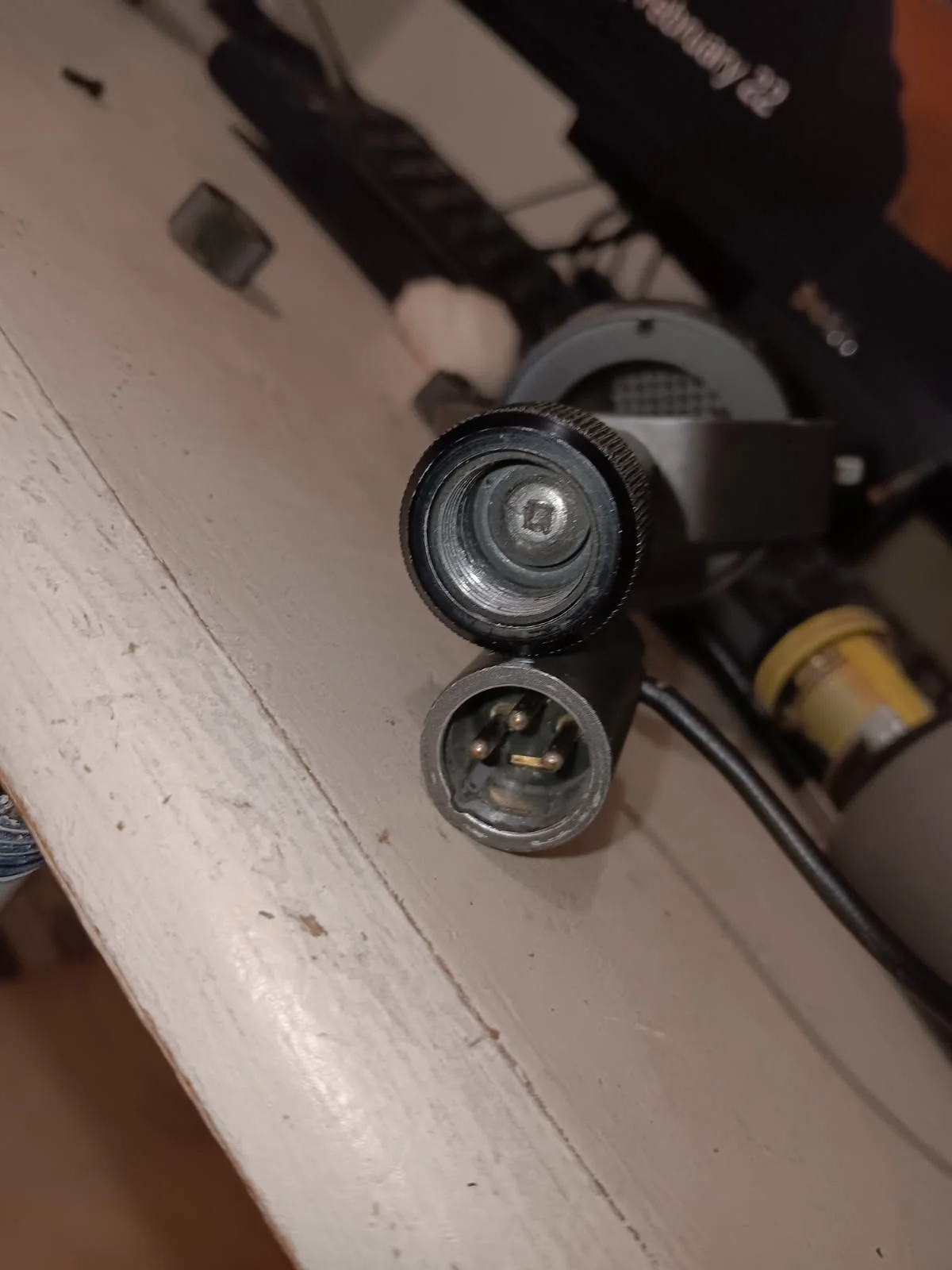

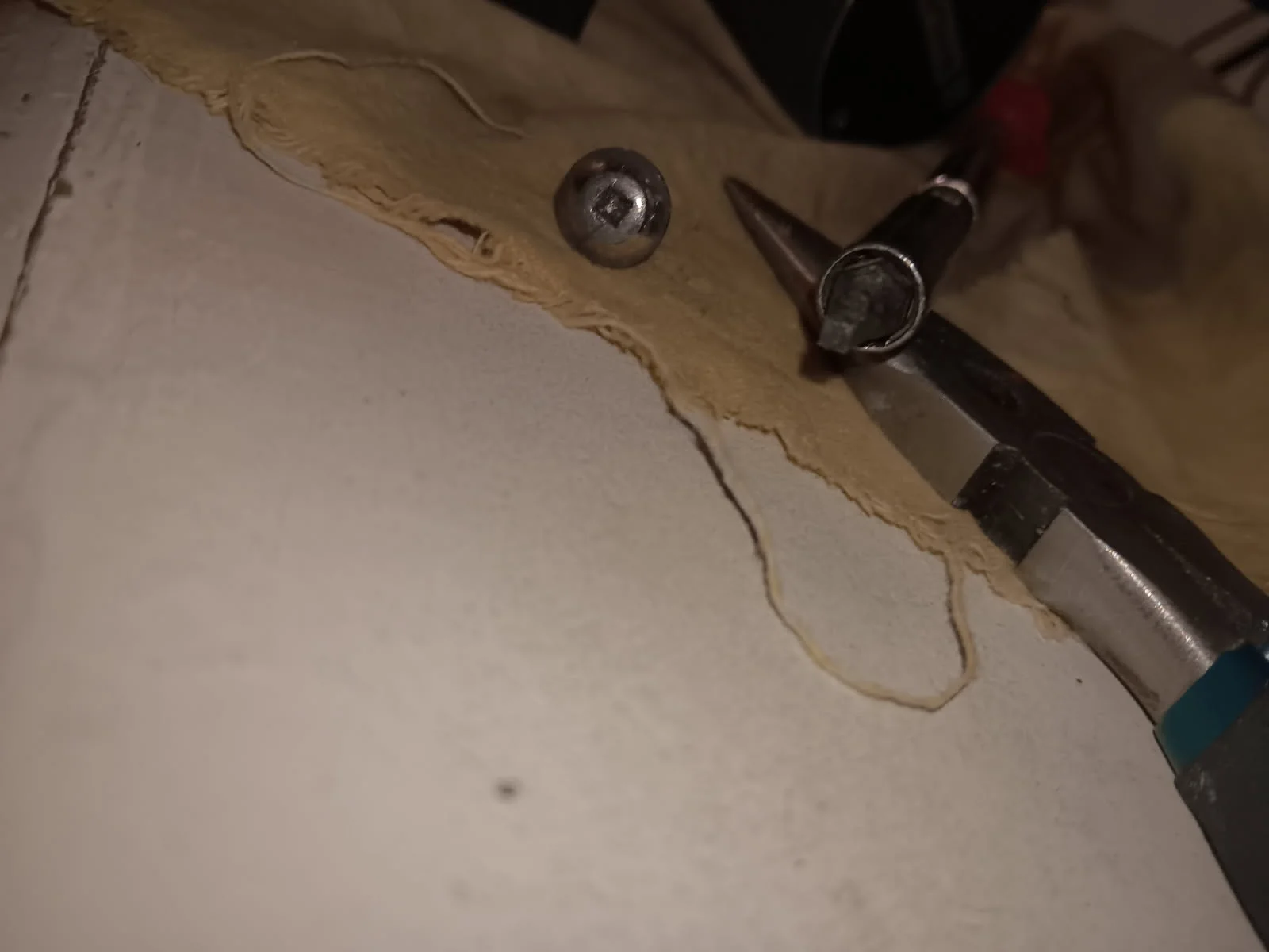

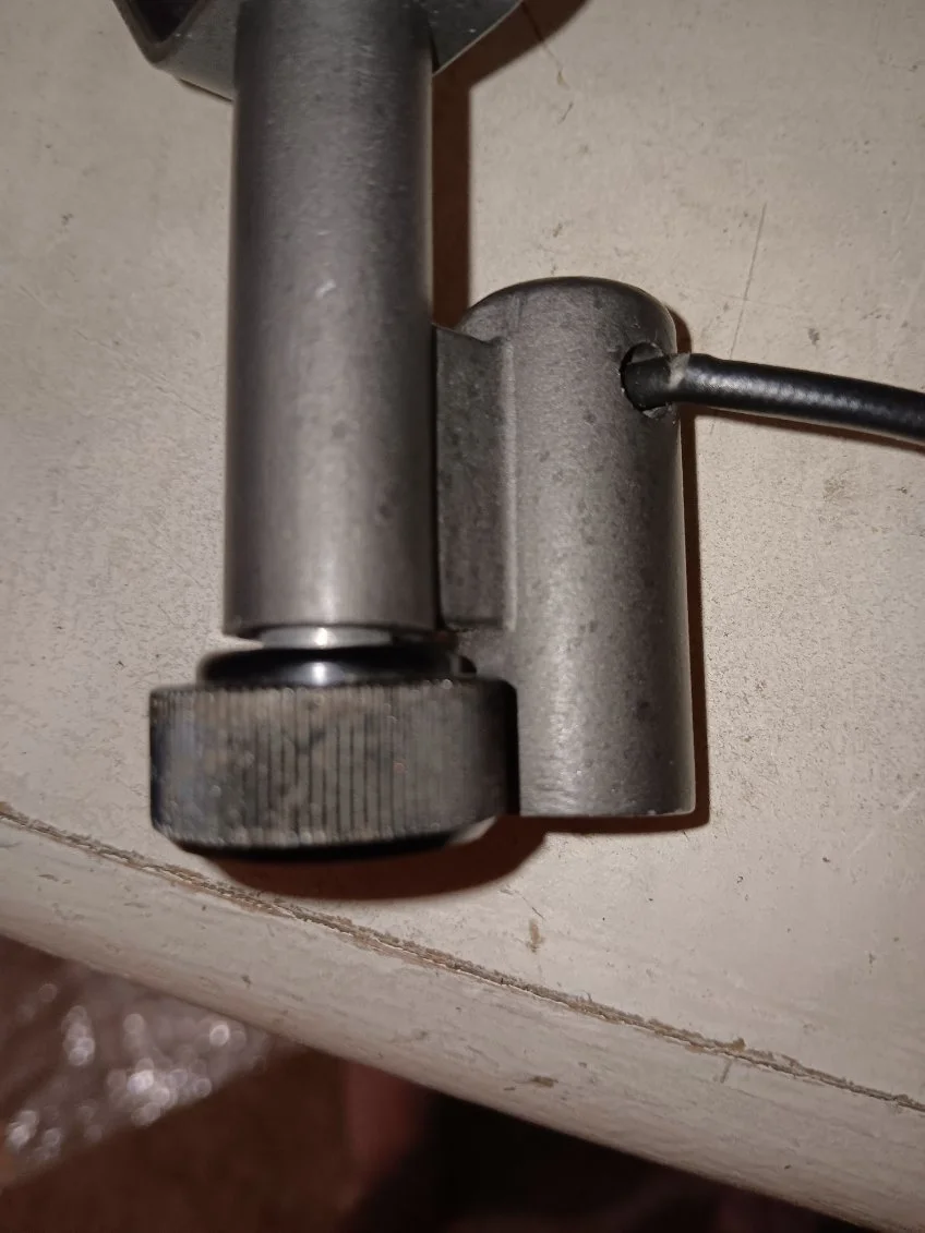

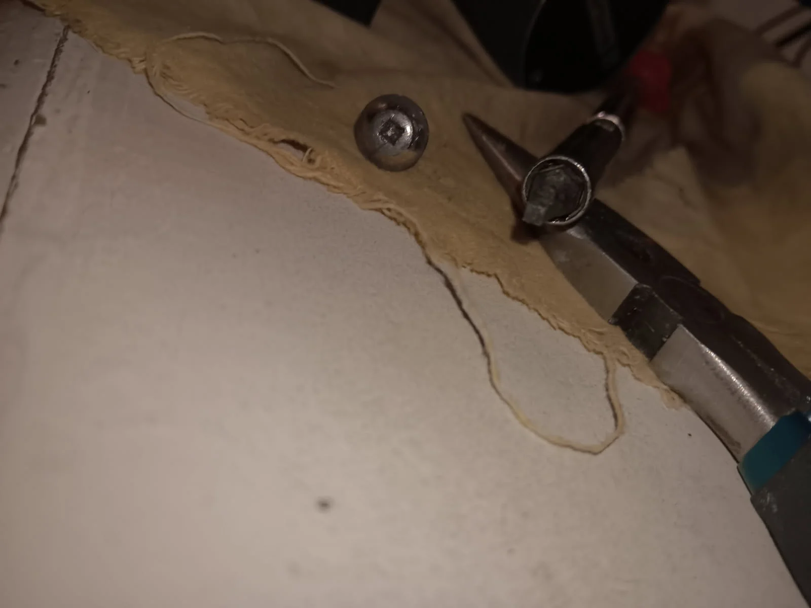

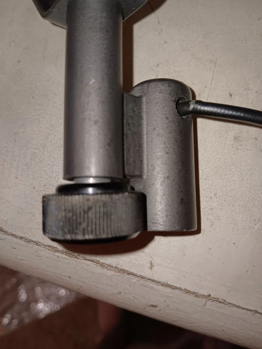

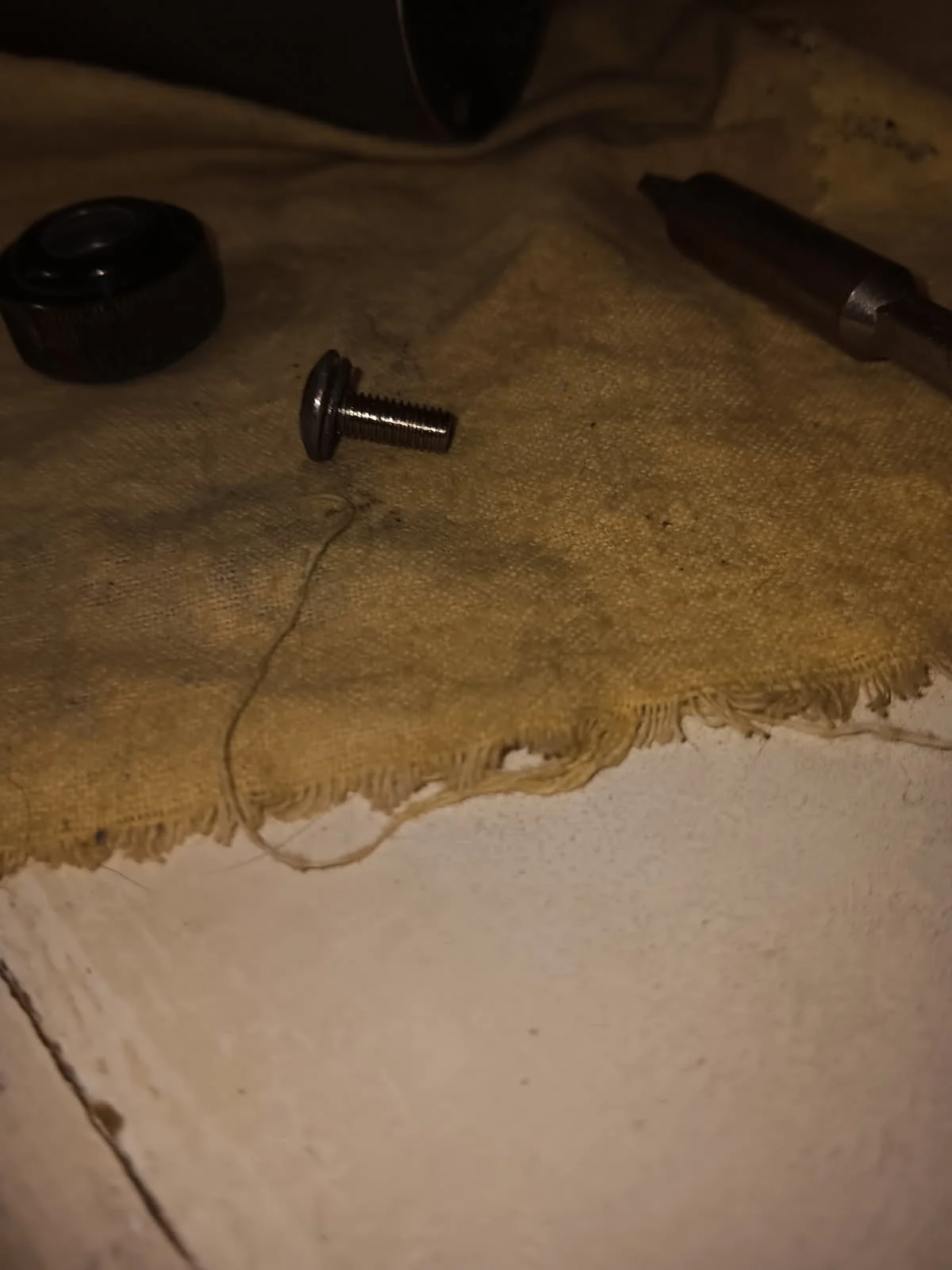

The stand nut screw was weird- a square screw, the new SM7b with standard Phillips much easier, but this is the old one a button head screw with 4pt "square" screw.
Pic 1-5

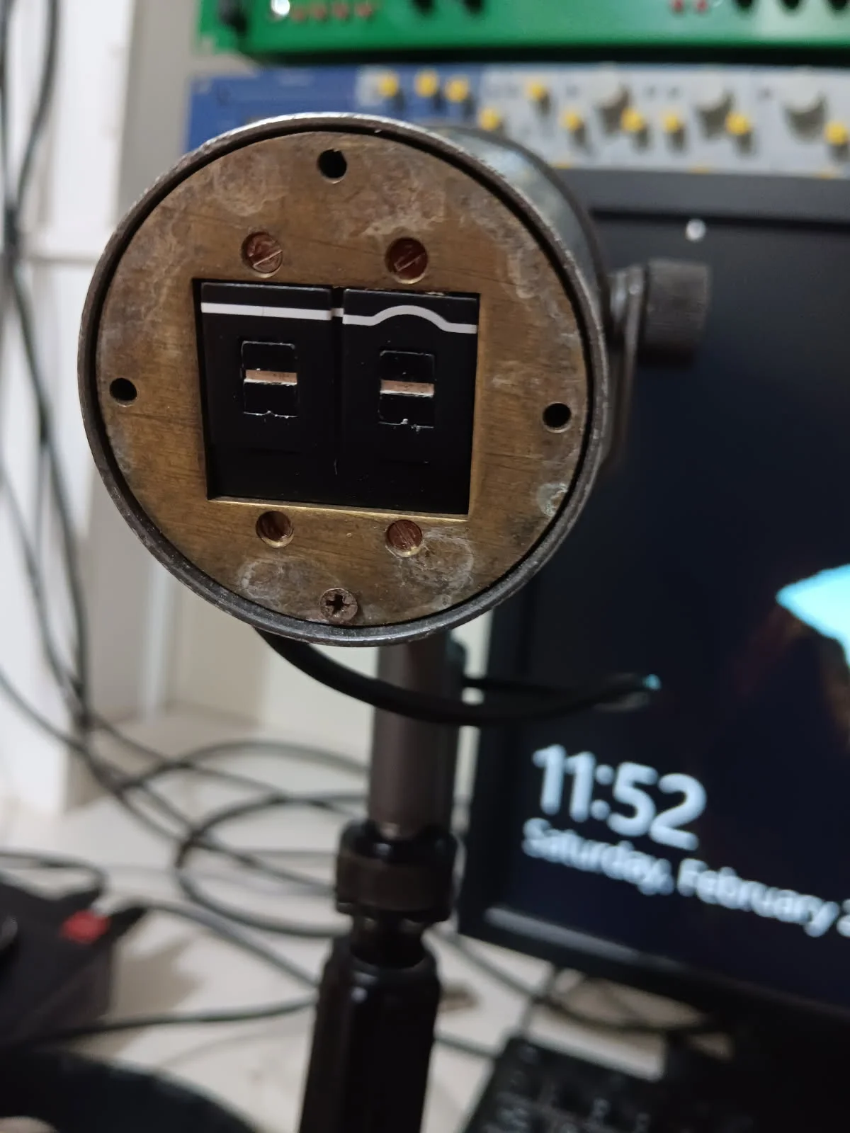

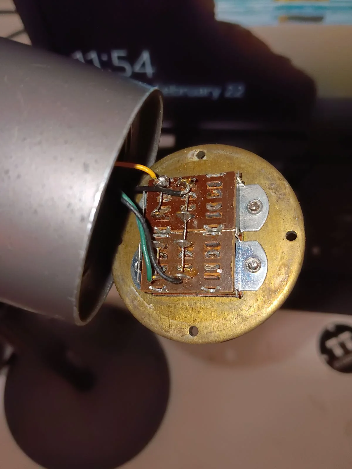

Backplate and EQ and capsule wiring
following pictures- noted inner body is painted and wiring colors.

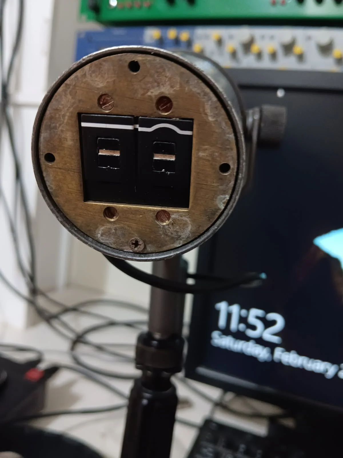

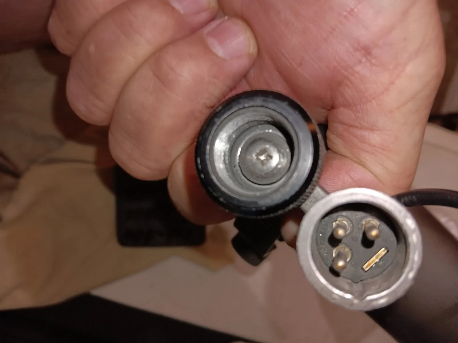

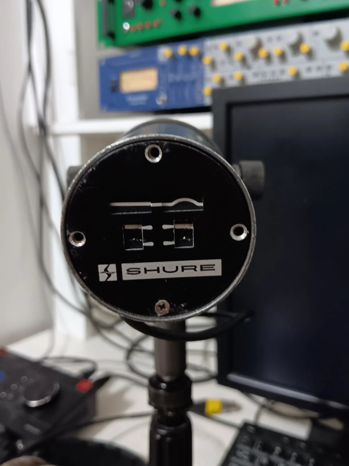

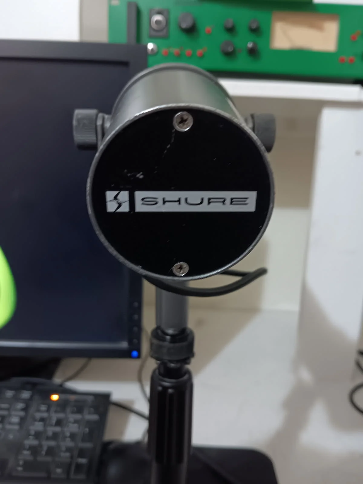

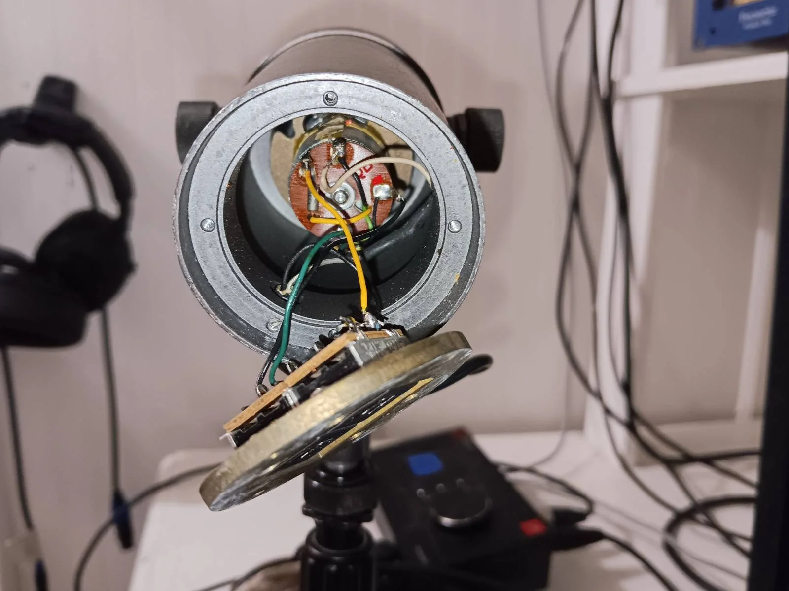

That's really good for identifying how it should look! thanks for this.
Its one early version at least to note a bit. Outside the no-humbucking coil and the humbucking coil there's not a lot of difference seen.
Looking at the newer SM7b's I have there are good improvements imo, over the original ones.
1.Putting the XLR in the front seems to be popular (which can be done with any model of these)
2.The mic stand is now a Phillips/cross screw instead of this old weird square screw.
Seems most everything is still to the same spec/design and interchangeable from old to current. Some decal/label changes, nothing important.
As with old vs new in sound? gets crazy....the capsules and magnets etc, and age seems to be the "sound" difference debated forevermore. For gear collectors the old ones will go up in value
Shure has a number for the tiny screws pn 30D443E but they don't seem to sell them. Not much info on them I could find. But then another Shure Product seemed to have used the screw p/n and there were details its M25, and that's a o.08 size! 80 thousandths of an inch, so many people seem to lose them. To be honest 2qty hold the back plate/EQ plate fine but 4qty is the full set. I found that interesting as I need to order some. $7 for 10 of them or something.
UPDATE: Seems the tiny tiny backplate screws are technically called "2-56 x 5/16" , ( .086 dia x .31x Long ), the ones I got were too short in length so don't buy the 1/8/.11.

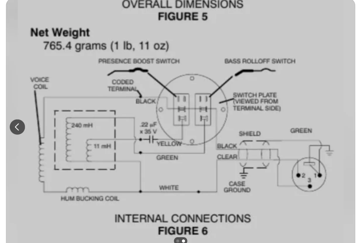

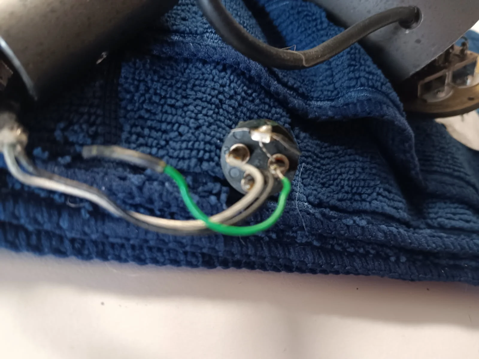

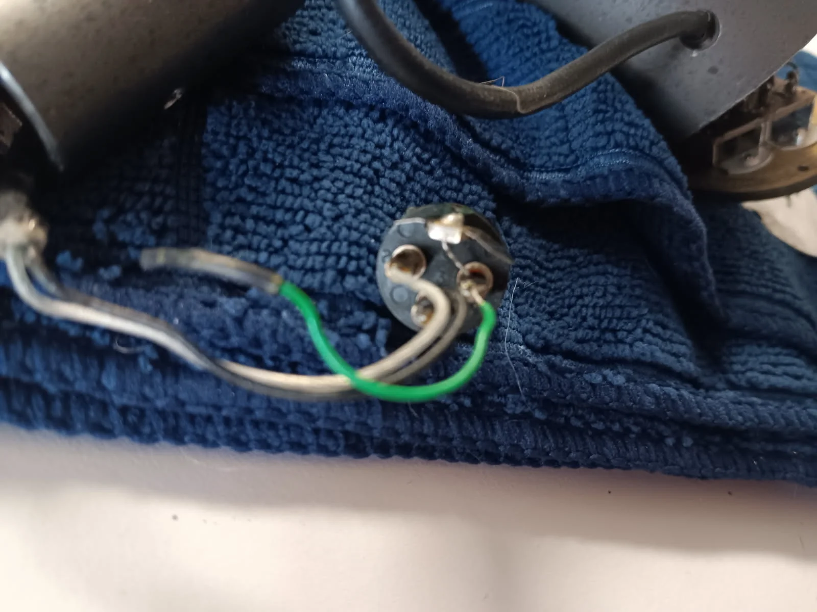

I also found the XLR shield wire intentionally not connected, with the black and clear wire going to the mic PCB. Because the pin 1 is connected to the case of the SM7, shield wire. There is a fine wire jumper from Pin1 to case ground. Inside the mic there's no green wire from the XLR. Anyway the old one works and noise was identical to my new SM7b.
In the picture it shows only black and clear going into the mic body and the XLR shows the pin 1 green with heat shrink on it? wierd. It works fine!

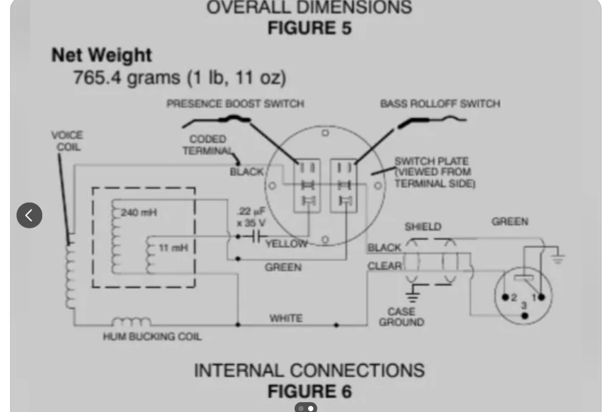

The humbuker is just a counter-wind tied in series. so they act like a small inductor filtering way past the audio range and counteract proportionally when electro magnetic radiation imposes on the mic coil. But since the inductance is small they don't interfere like they do with guitar pickups.

Hi Cool Cat, I can answer some of your questions I think from "first principles?
But first let me nail down the operation of the Hum Bucker Guitar Pup? Yes, this has two coiis but they are not 'contra wound' merely connected out of phase*, usually in series. This would normally give a very weak output akin to the "reedy" sound you get with a Strat with the selctor switch mid way betwen two pups. The HBGP is clever though and they REVERSE the polarity of one of the magnet strips. Thus the output voltages add.
A "DC coupled pre amp" (or AI for that matter) is one where no capacitors are used in the signal path. The idea is that this avoids the use of electrolytic capacitors which, it is claimed cause distortion. Well yes they do but for coupling duties (one part of a circuit to another) the simple solution is to make them large enough in value that distortion is next to nothing down to any desired LF limit. 10Hz say? DC coupled amps are more vulnerable to external voltages e.g. phantom power and difficult to protect, especially in the knockabout world of the studio and PA!

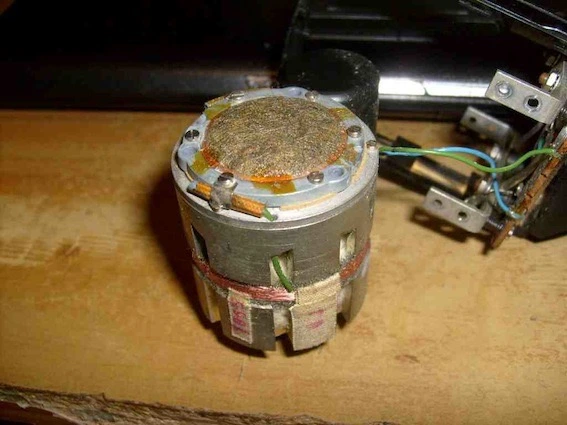

Part of my question was trying to find a picture of the hum-bucker coil wire in the capsule. Just curious what it physically looks like.
The capsule wiring can be seen in repair- videos but Im trying to see what this SM7 coil- that was added, looks like. It's all just curiosity...
so you mentioned its wrapped in a opposite right vs left, and its not a "part" like the schematic shows the coil as a wave-y symbol.
Is it equal number of windings turns or only one wire wrap? sorry too many questions! lol
Ideally it should be the same specs, position, and orientation, as the moving coil.
That's not possible so, as far as I know, they get as close as they can.
I don't know if it's length of wire or number of turns which is most important.
Maybe someone else will know, but the idea is they're subject to the same interference as the moving coil, but not the wanted signal.
I haven't seen it on the SM7B - I assume it's hidden by an outer shell or something,
but it's visible on the old AKG D12 capsules.
It should be shown in a schematic. It is for the D12.

That is because that was added later to the D12. SM7 is on the diaphragm coil assembly like most mics engineered with a humbuck.
In any system that uses a hum cancelling coil the important thing is that it injects a hum signal of opposite phase (polarity to be more accurate) and of equal magnitude to the unwanted hum signal. Naturally since two coils cannot exist in the same point in space there are limitations to the concept.

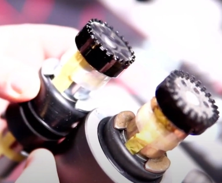

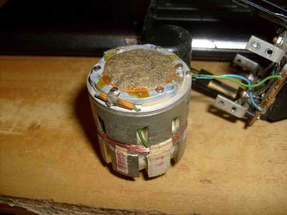

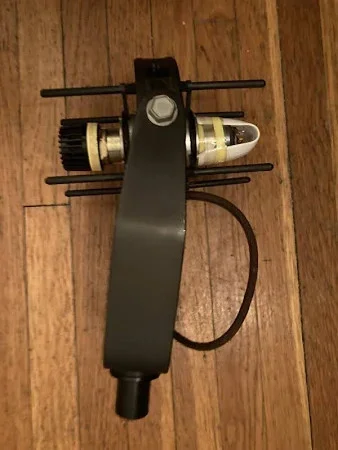

Some guy on youtube doing a 7b capsule replace.
That looks, to me, like an external coil on the right-hand capsule.

the D12 picture was a good visual, inversing the hum is understood for cancelling.
I suppose there was enough of a humming environment they felt the need, or by demand, to deal with it.
they chose putting it near the capsule instead of on the output it seems.
