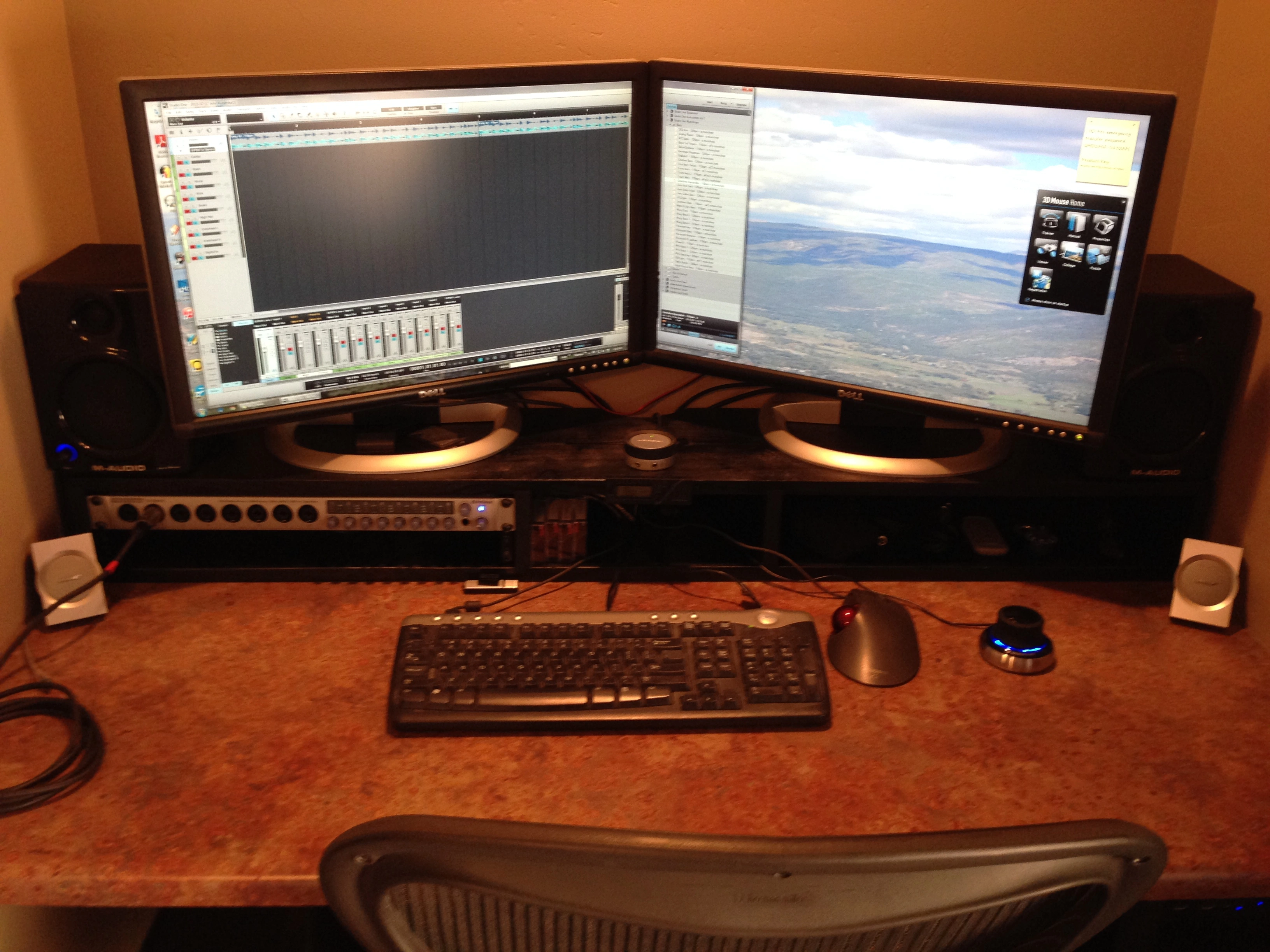

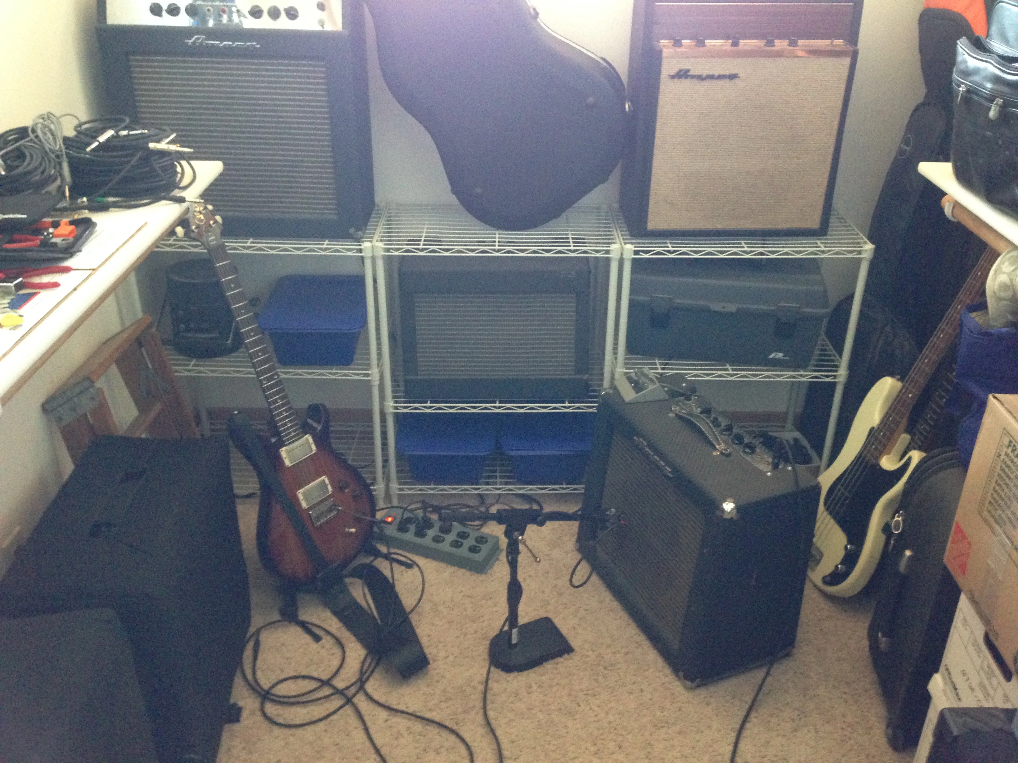

I'm new to recording and currently use a Presonus Firestudio Project with an SM57 to mike a guitar combo. It seems like there is hardly enough gain in the Firestudio Project mic preamps to get decent sound levels from the SM57. I had read that the SM57 requires a minimum 50db of gain to get anything out of it and the preamps on the FsP are rated at 50db of gain.
Is it worthwhile to buy a single channel tube preamp for the SM57 before running it into the FsP? In order to see any signal at all from the SM57 I need to crank up the mic preamp gain to max which then starts to distort. I want great guitar sounds from this setup but it seems like I'm gain deprived at the moment.
Thanks for any advice offered!
