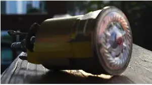

+1.
Don't be fooled by anything that looks like this.
An sm57/58's innards should be solid metal with no hollow cavities, like this.
The rule with 57 capsule (and Sony 7605 headphones) : If the price is good, it's not real!
