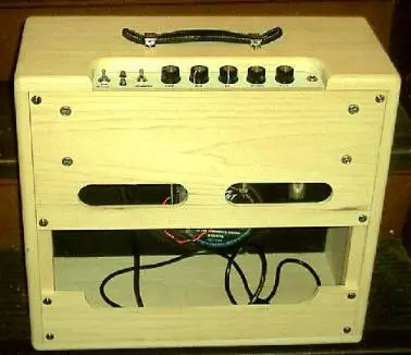

Here's the l'il Girl. Her name is the Bluesbuster...

Great picture of your amp. I like how it sounds. Could you tell me more about your amp??, watts, speaker size, etc.

OK, about the amp. The preamp is loosely based on the 76-81 2203/2204 Marshall Master Volume Model. EH 12AX7 Preamp tube. Two gain stages before it slams into the tone stack which is your basic Marshall Plexi/Metal Face Tone Stack. Then through the Master Volume directly to the Power Tube via a 1.5k Resistor.
The power amp is Single Ended Class A and produces about 15 loud watts.
Much like the THD Univalve, it's cathode biased so you can use virtually any Octal Power Tube such as the 6L6GC, EL34, 5881, 6550, KT66, etc., without rebiasing. It can also run the 6V6GT with a change of the Cathode Resistor. That can also be made switchable.
Right now, I'm running a JJ 6L6GC in the Amp.
It's wired PTP on a G10 Epoxy Eyelet Board. The circuit for the amp was designed by Phil Rowley at AX84.com.
Controls are Input, Gain, Level, High, Mid, and Low. Standby, Indicator Lights, Power.
The l'il girl responds great to pick attack. Never touched the volume controls when I was tracking that clip.

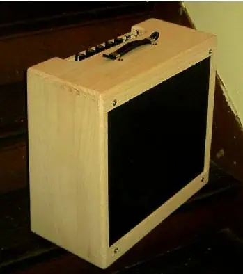

It's housed in a Custom Oversized (1.25" taller) 5E3 Cabinet by Eric Rombinas of Vermont. The Cab is Poplar Wood. I havn't had the heart to put a finish on it yet and would never cover such a beautiful piece of wood with Tweed or Tolex. I'll get around to it one of these days though. I'll either Tung Oil it or stain it.
Right now the cab has a Peavey 12" Blue Marvel Speaker in it that came out of my Peavey Prowler 112 Tube Amp. A speaker upgrade is coming. But the Amp is so rich sounding that it makes just about any speaker I have tried sound decent.

Anyway, here's another pic of her...
