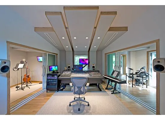

Wow, I bet those ^^^ aren't cheap. And a maximum of 70dB Sound reduction. And in the tracking room, another hard reflective surface to deal with.
Sliding door seals would likely be the biggest issue with that.
The glass in the photo above was likely beyond most reasonable cost. Just like a viewing window it needs to have multiple layers of varying thicknesses to efficiently stop sound waves from getting through. Likely $900 for a 4' x 6' panel. I couldn't imagine what a sliding pair of doors built like that would cost...
Looks cool though! :)
Well,the OP asked.
