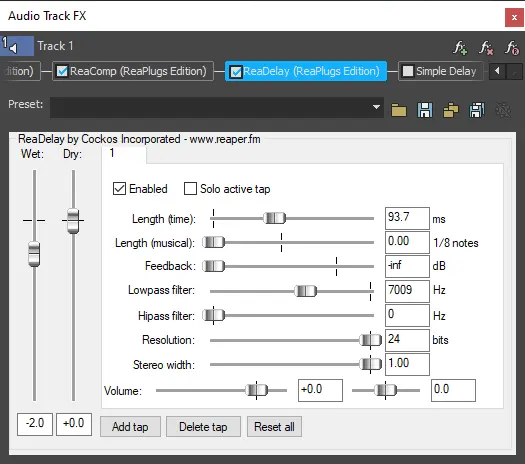

Slapback is so easy that you don't need presets. Just set it to about 100 ms with no repeats. You can copy the settings in the pic. (Note, these settings are for inserting the effect directly on the track. To use it as a parallel effect, set the Dry slider to -∞.) Adjust the Length and filters to your preference.
