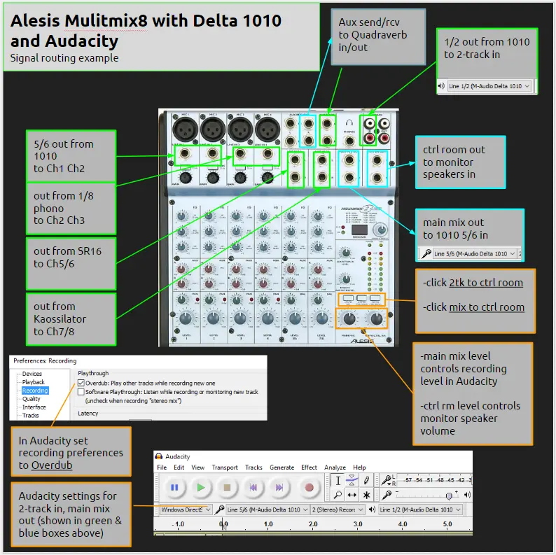

Signal routing for multi-track recording with MulitMix8, Delta 1010, and Audacity
  • Thread starter Thread starter James Brauer
J
James Brauer
I realize this is a pretty specific setup. It took me a good while to get all this working, so I thought I would document what goes where. This will let me record each track individually in Audacity, while monitoring other tracks. The added benefit is I can use this setup to play around live without any computer involved, or mix multiple live inputs into Audacity while monitoring previously recorded tracks.
