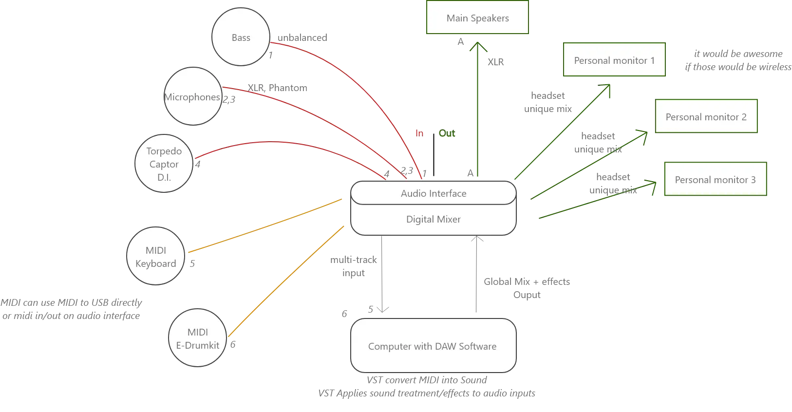

I have some experience with home studios myself, as I made some productions in the past. I just moved to a new place with a musician friend, and we are looking to go next-step and forming our home-studio that will be mostly dedicated to live music playing in the appartment.

That would about 4 audio input (jack/XLR, some unbalanced and some balanced) and 2 midi inputs, meaning 6 tracks recording at the same time.
I attached a scheme to the original post.
Understood for the interface, the first step for me is indeed to define the vocabulary. It would be important for me that this interface gets different buses for different monitor mixes.

For audio it looks like you just need two XLR microphone inputs and two DI/instrument inputs.
A lot of interfaces have a switch to allow DI/instrument on their first to inputs, so have a shop around and see what you can find.
At a quick glance, something like the Focusrite 6i6 should cover your needs with two DI and two XLR with phantom power, simultaneously, and a midi input.
It, like most audio interfaces, also has your headphones and main monitor outputs covered.
Multiple headphone mixes can be a bit tricky.
There's two main ways this is done.
One is a fancy system that sends everything to everyone and offers each headphone-wearer their own 'mixer' or control panel to customise what they hear.
That's $$$.
The other is to manage submixes in your daw and send them to different stereo output pairs on your audio interface.
So musician A is hearing a mix going to out 3+4, musician B hears what goes to 5+6, etc.
The latter option means you'd need multiple line outputs on the audio interface, and a headphone amp to go with each pair. (or a multi in/out headphone amp.)
That focusrite I mentioned only has two pair line outputs, and one of those is main mix, so that would afford one additional custom headphone mix.
I guess you'd be looking for something with, maybe, 8 line outputs?
