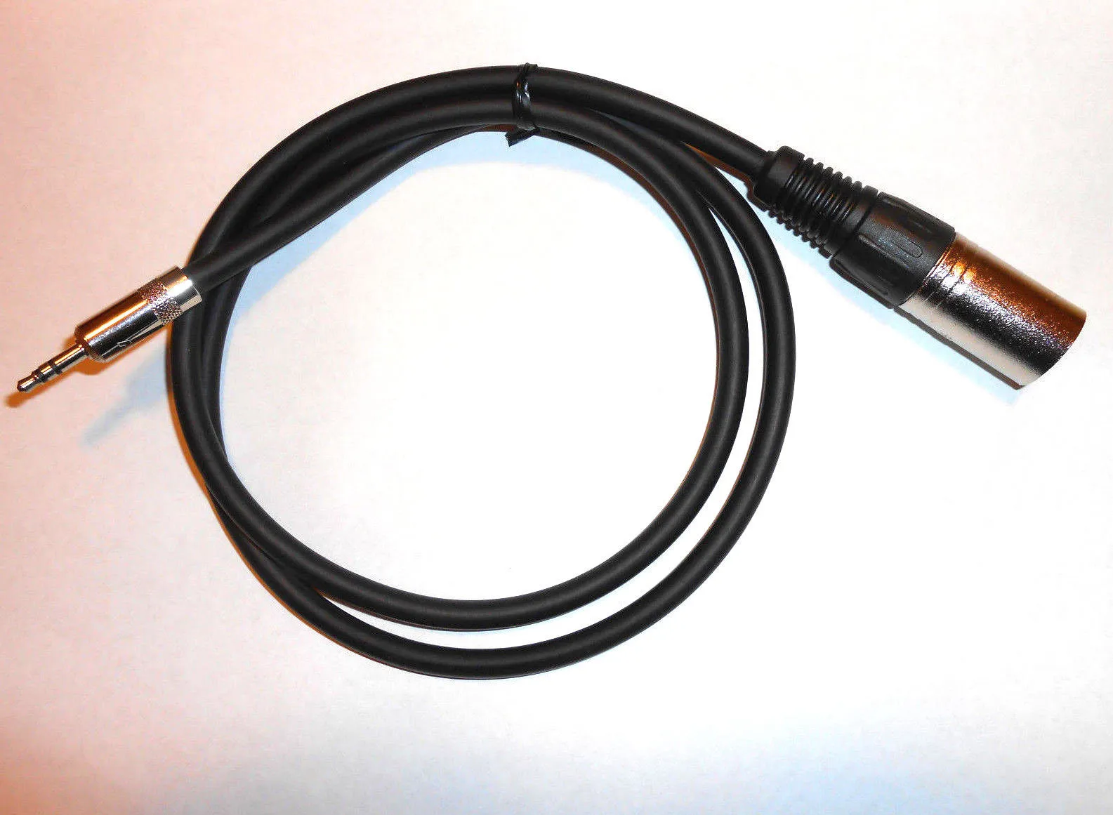

I always needed a preamp to raise the levels to usable with SM57 through my PC before. Are you saying that iPhone has enough gain for acceptable levels? I mean I can get one and try it out.
I have one of these (that is the headphone 3.mm mini jack) and just tried it out and it doesn't work. iPhone doesn't recognize it as external mic. Still uses its own external mic.
Is XLR to mini jack that I need different than standard 3.5 mm?
The picture I posted was from ebay and said it was a microphone adapter for iPhone...maybe the jack is specifically wired to work with the iphone...Perhaps it was mis advertised ...being as the original iphone headphones with mic plug / jack is a 3 ring ( 4 pole) not 2 ring allowing it to work as both a headphone and microphone jack all in one
